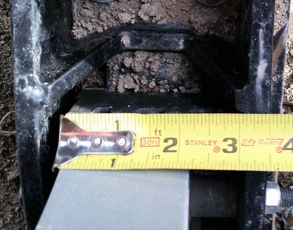

First time post, but I have a question. Will stock 2010 Nytro MTX skis work on my 2016 Venture MP? I have the stock tuners on there now, but they stink when I get into the powder. I'd like to try something that'll float better, but don't have a ton of cash to experiment. Thoughts?

I think they would swap right in and would work a lot better than the tuner junk. There might be a little bit of modding of the ski mounts as the MP's spindle is wider than the Nytro's.

Looks like 2 1/4" for the spindle, and about 3 1/4" inside the ski (with spacers to make up the gap). Does the sound like it'd work?
- 7,693
yes they should work. i would use the nitro mtx ski tubes in the spindle as i have had them brake the bolt off on a landing on other sleds. chunks of pipe will work for the spacers, using a hunk of jack handle for a spacer on a sled.
