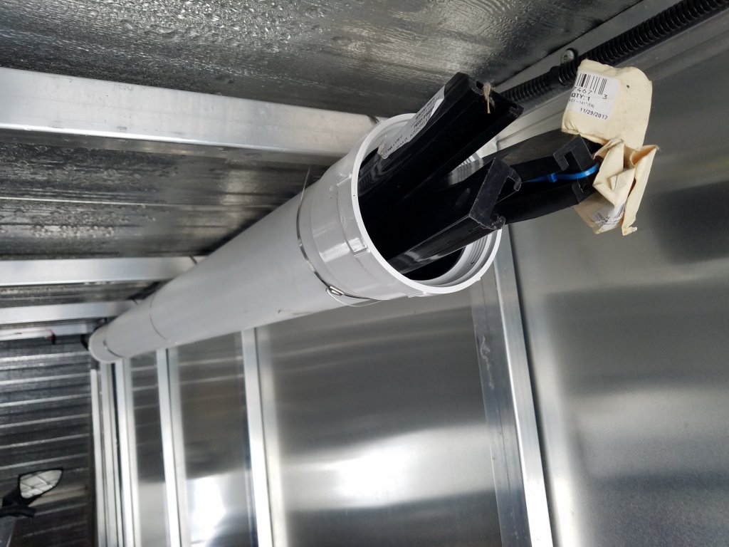

View attachment 151692 View attachment 151693 View attachment 151694
Out of the way, but there when you need them...
4" PVC, a sold end cap, a threaded end, and a threaded cap. Held to the ceiling with stainless cable ties. Thanks to my brother for the suggestion!
Awesome idea!!
- 7,681
that is a good idea. at some point i am going to put a work bench in my trailer over my tool box and heater. i was planning on using 4" exh to hold them up right on one end.

I like that idea too... Vertical mounting would work equally well. Wish I had room for a work bench (or even a tool box or heater) in my 2-place!that is a good idea. at some point i am going to put a work bench in my trailer over my tool box and heater. i was planning on using 4" exh to hold them up right on one end.
