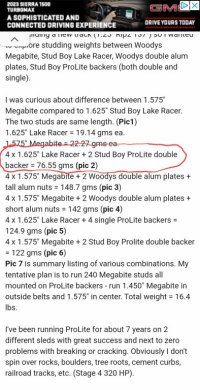

I was curious about difference between 1.575" Megabite compared to 1.625" Stud Boy Lake Racer.
The two studs are same length. (Pic1)

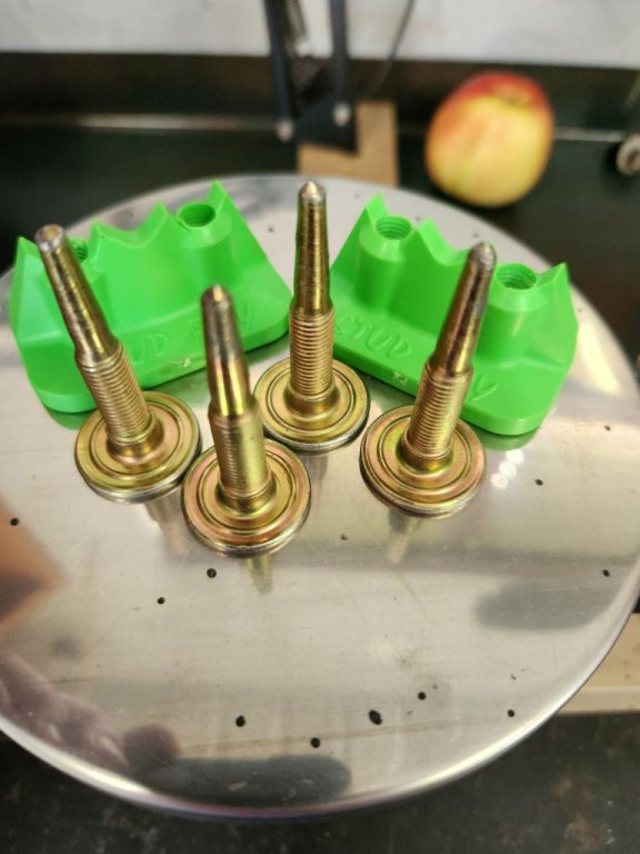

4 x 1.625" Lake Racer + 2 Stud Boy ProLite double backer = 76.55 gms (pic 2)

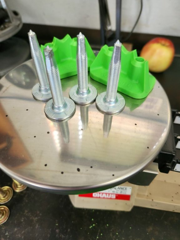

4 x 1.575" Megabite + 2 Woodys double alum plates + tall alum nuts = 148.7 gms (pic 3)

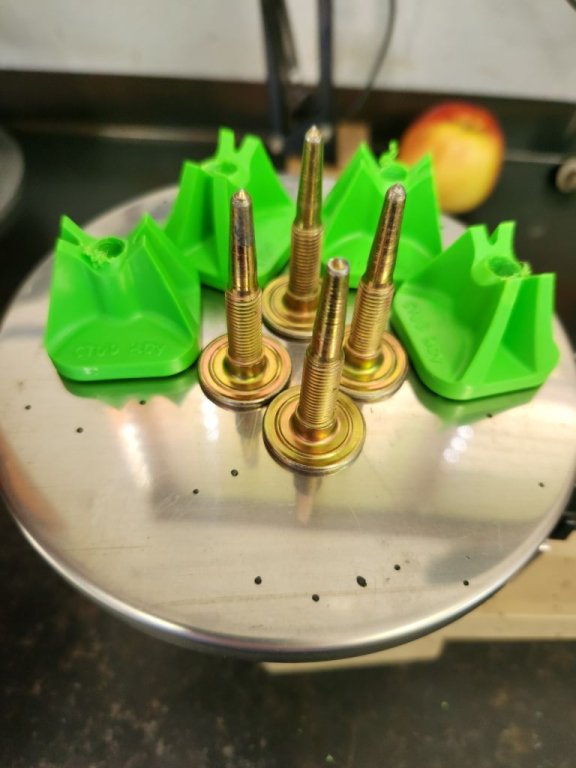

4 x 1.575" Megabite + 2 Woodys double alum plates + short alum nuts = 142 gms (pic 4)

Pic 7 is summary listing of various combinations. My tentative plan is to run 240 Megabite studs all mounted on ProLite backers - run 1.450" Megabite in outside belts and 1.575" in center. Total weight = 16.4 lbs.
I've been running ProLite for about 7 years on 2 different sleds with great success and next to zero problems with breaking or cracking. Obviously I don't spin over rocks, boulders, tree roots, cement curbs, railroad tracks, etc. (Stage 4 320 HP).
Bottom line is Megabites are 16% heavier than Lake Racers (probably about same for Triggers). ProLites are about 18% lighter than aluminum plates w alum nuts.
