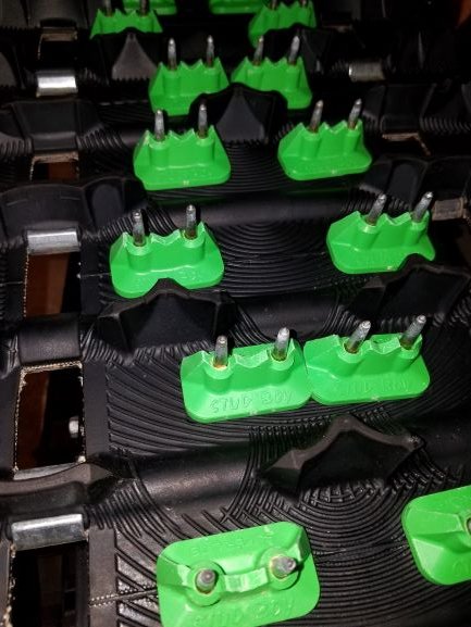

192 ea. 1.630" StudBoy Lake Racer carbides mounted on double StudBoy ProLIte backers. IMO, lightest setup possible. I weighed both my setup against double aluminum setup and Prolite setup is lighter by 15%. All in middle belt. Track is 1.25" Ripsaw2. If you don't spin over cement curbs and boulders, very durable setup. Only lose a couple tips in a 2500 mile season.

Both. I am in Midwest and 90% hardpack groomed trails (some ice). The advantage with ProLite backer is it also acts as a scoop (see pic) if installed facing the correct (by StudBoy's spec) direction. So then you not only have the 1.25" Ripsaw2 lugs but you also have the combined effect of the ProLite backers adding to the scooping/paddling effects, and on top of that I have the 1.62" carbide tipped Lake Racer studs to cut into the ice or hard pack. Great traction! BTW - I spent allot of time "countersinking" the heads of the studs into the quiet track. Bought a 15/16" hole saw, figured out a stop to allow it to cut into quiet track just the right depth (to get the head of the stud flush w inside of track), and then used a carbide die grinder to remove the little circle of quiet track material. Then, use 5/16-18" tap (or whatever matches the studs you're installing) to tap the ProLites. Apply a drop or 2 of super glue to threads in the backer, then screw stud in and tighten. NEVER have had any come loose. Have to heat stud to get one out. Don't have tunnel protectors and don't need them. Even these 1.620" don't hit anything in tunnel. Keep track adjusted right. Track runs very quiet on stand and very smooth on snow because studs are flush to inside of track. See pic. Prolite backers are tough and durable. Of course, I could ruin them by spinning over railroad tracks, cement curbs, boulders, etc, etc. But, I don't do that! This setup works great for me.
