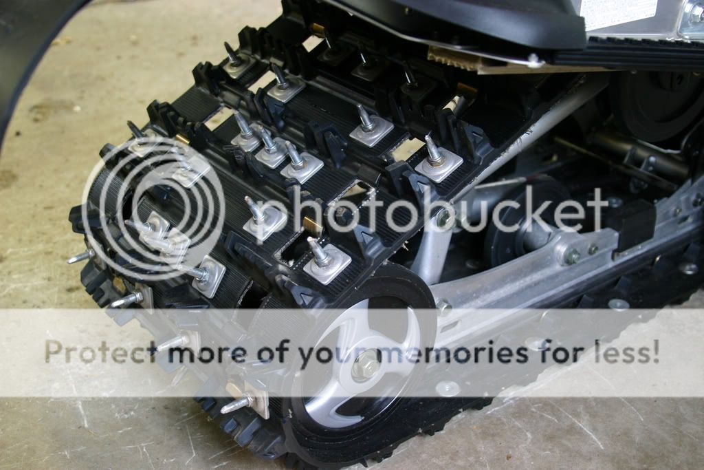

flmcut1
this is what i got now

I'm a very agressive rider and have every other outside lug studded and haven't had any tear outs.
NB-NYTRO
mrance111 said:I'm a very agressive rider and have every other outside lug studded and haven't had any tear outs.
You did a nice job studding it. You squared up your square backers. Thats the way to do her if you don't want tear outs. I'm taking my ripsaw off and going with a fully clipped 1" track with 192 studs. I hope it hooks up a hell of alot better. I had my Viper studded on the outside and I only ever lost one stud after alot of abuse... ha-ha
