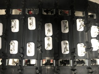

On a 1inch track? What protectors do u have?View attachment 156196 I’m running Woody’s Gold Digger 1.450 on Stud Boy pro-lite double backers

Can't say enough good things about the Stud Boy Super Lite backers. The backer also acts as an additional paddle. Put over 10,000 miles on them and the pointed ridges on the backer were worn down but the paddle itself was still intact with no tear thru; although I only stud down the center.
RAMSOMAIR
I usually run the Woodys aluminum double backers. Since the new to me SRX has a 1” lug I was looking for a little help in the traction and decided to try these. With a 270 tune l’m sure I will be wearing them down too lol

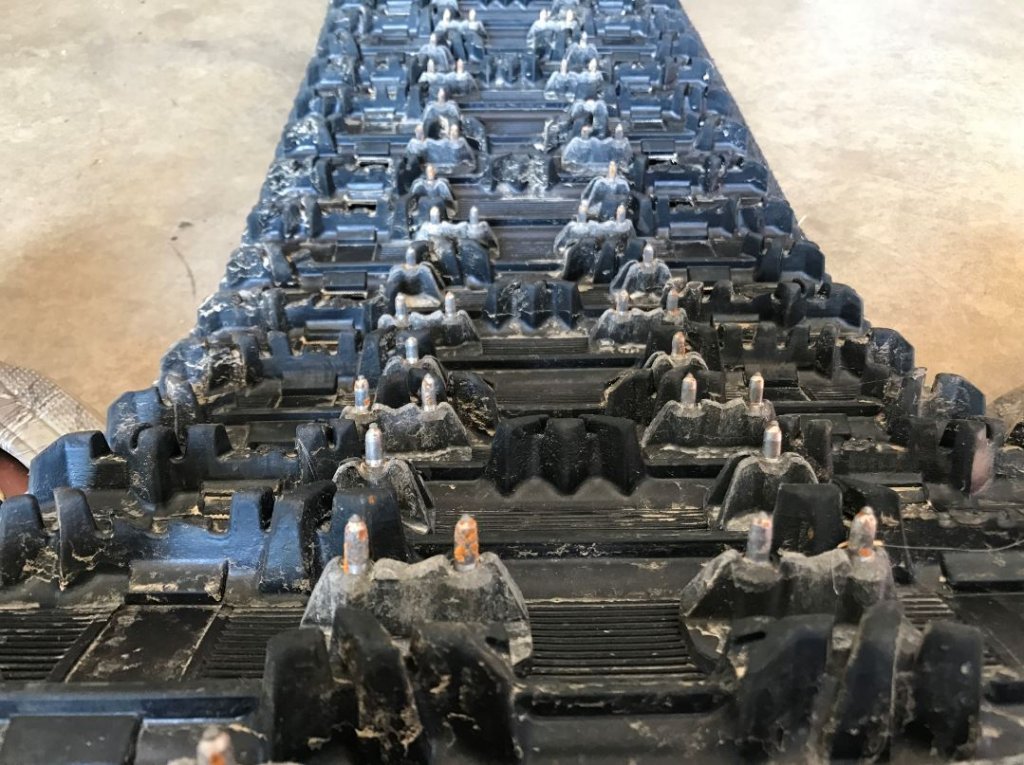

Actually, you might be surprised at how much they don't wear down; of course, I'm not running a 270 tune but I bet they still hold up. Here's a pic of my old track with those backers that have over 10,000 miles on them:
RAMSOMAIR
Thats good news. I don't spin like an idiot on take off or over rocks and pavement anyways.
