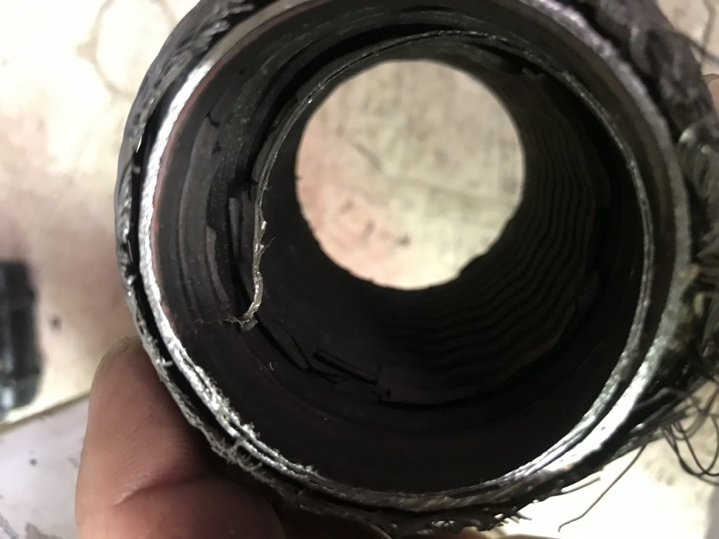

Take a good look at your flex joint. They can leak and with a turbo the pieces could very well end up going through it.
Here is mine. Pieces. Big ones were found in muffler.
Can’t imagine they would make it though a turbo without damage.

Serious stuff right there, what caused it?Here is mine. Pieces. Big ones were found in muffler.
View attachment 153702 View attachment 153703 View attachment 153704
Miles and age. This is usually the first piece to go in a car exhaust too.Serious stuff right there, what caused it?
