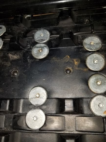

I have run these ProLite backers for 2 years (about 4000 miles) on Midwest groomed trails in both good conditions and some poor. I am mindful about where and how I use throttle (like not spinning track over cement curbs or rocks when possible). I have only broken 1. I am using 1.62" carbide Lake Racer Stud Boy studs (192). I made a little modified hole cutter tool to remove the quiet track lug where the stud heads are. It's a 15/16" diameter hole (diameter of Stud Boy Lake Racer head) drill with a settable stop on it. It works great. I end up with head of the studs flush with inside of track and when I run it on stand I can hardly hear there's studs in the track.

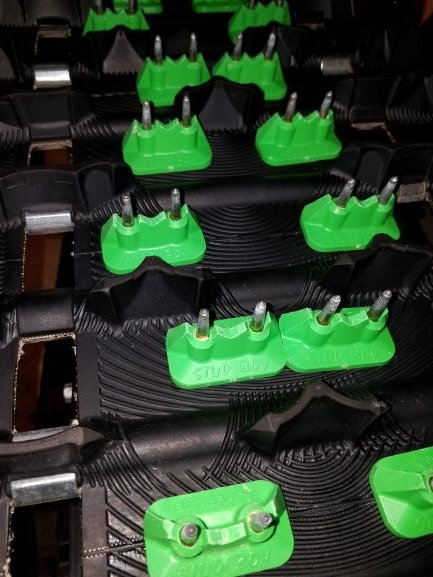

Last summer I stopped by the Stud Boy display at Hay Days and chatted about best (strongest) was to install their Lake Racer studs with ProLite backers. They advised me to run a tap all the way through each hole and then when installing each stud apply a drop or 2 of super glue. Tighten stud to just before stripping and best to only use a hand ratchet (not air or electric impact) so you can feel how tight the stud is. They're hard to strip (with a 3/8" hand ratchet) believe me. The downside of using super glue is it basically welds the stud into the backer. If you ever need to remove a stud, just apply some heat to it first to soften the super glue. It works great. Never had a stud come loose. See pics.
