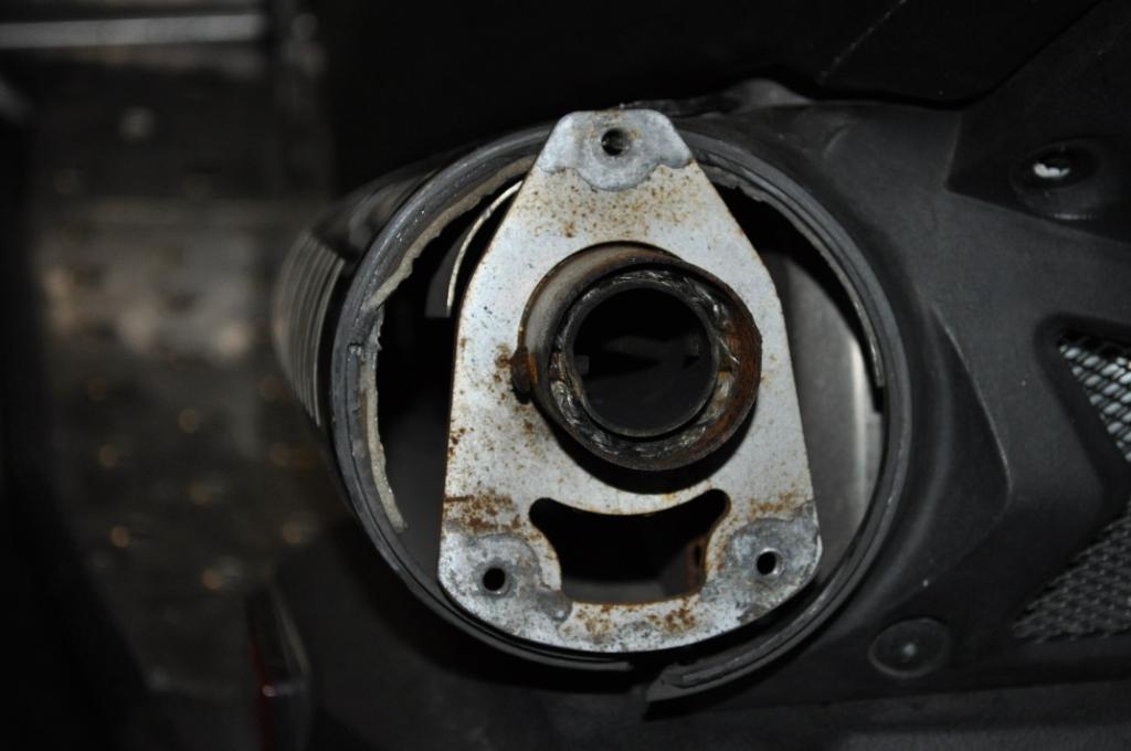

I have 2 buddies running them and they are not as obnoxious as the Hauck pipe and a little throatier than the Bender. They cost less because they use the stock pipe back to the can and the stock heat shield is retained.
I run Haucks on 2 of my sleds and contstantly have problems with the rivets and the resinator in the tunnel getting chewed up.
My buddy blew out the rear mono "W" arm on the rough trails 2 weeks ago up in the UP by the Hoop & Hollar. I left him run on mine (to get the trailer) it has a Hauck pipe on it with extra baffles in the outlets. I felt after runnining it for a year that it was not the noisy.
He left me along HWY 28 about 8 miles north of Sunday Lake in Wakefield. It was 11 pm and I could hear that sled the whole way untill it crossed the lake. I was liking it untill I realized everybody not sledding in the area was trying to sleep, the noise really carries.
I will be lookiing for a better option and the cherry bomb worries me because of heat. I know from my past experiences with gutted, Haucks and turbos the heat back there is incredible and I have melted seats.
Here is a pic of the inserts in the Hauck pipes when riding with a helmet the noise is about 50% but when the woods are quiet the squirells are disturbed.
