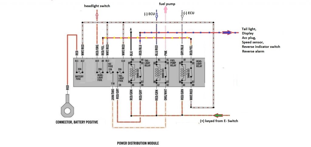

here is a start. If you pull the tail relay out and it still blows the fuse then it's before the relay. If it only blows with the relay in place it's the relay or a component after it. Check accessory plug for corrosion or if you wired in a heated shield to the accessory feed (tail light circuit) it could be that.

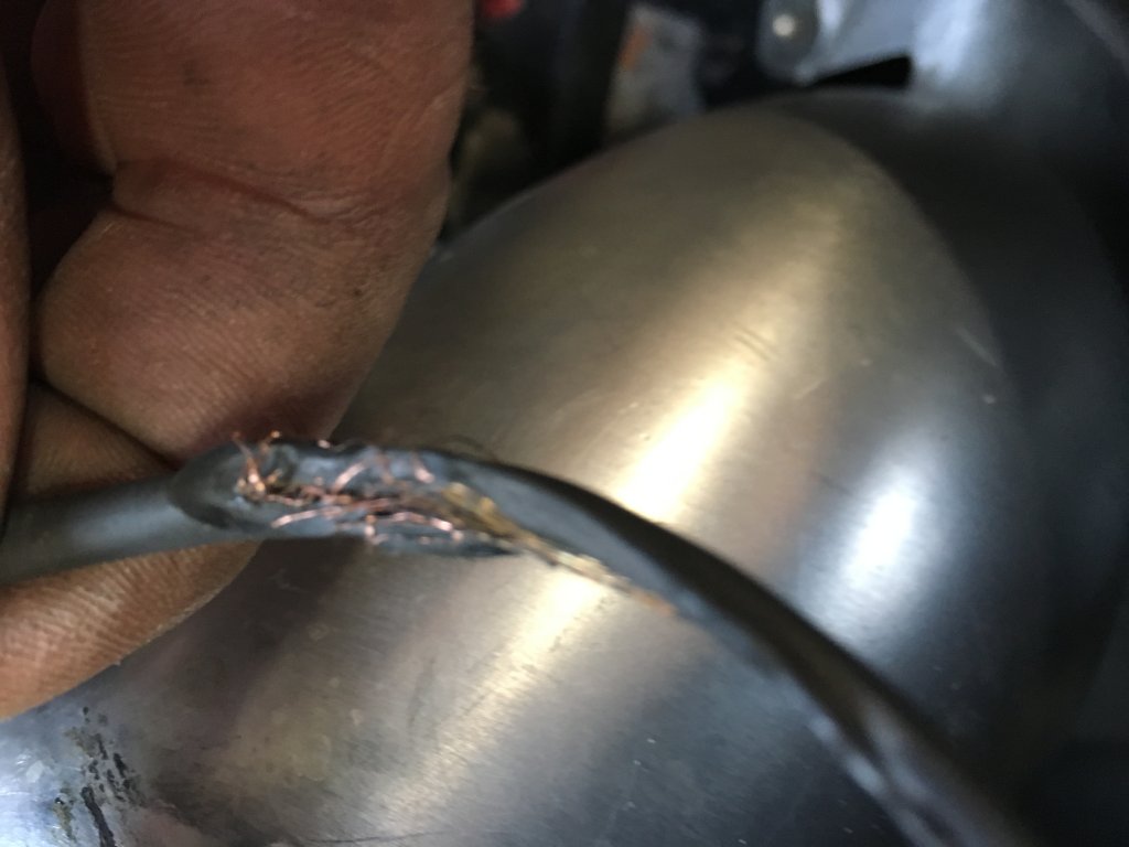

Heated shield wire melted on exhaust shield. Thanks Grizztracks
