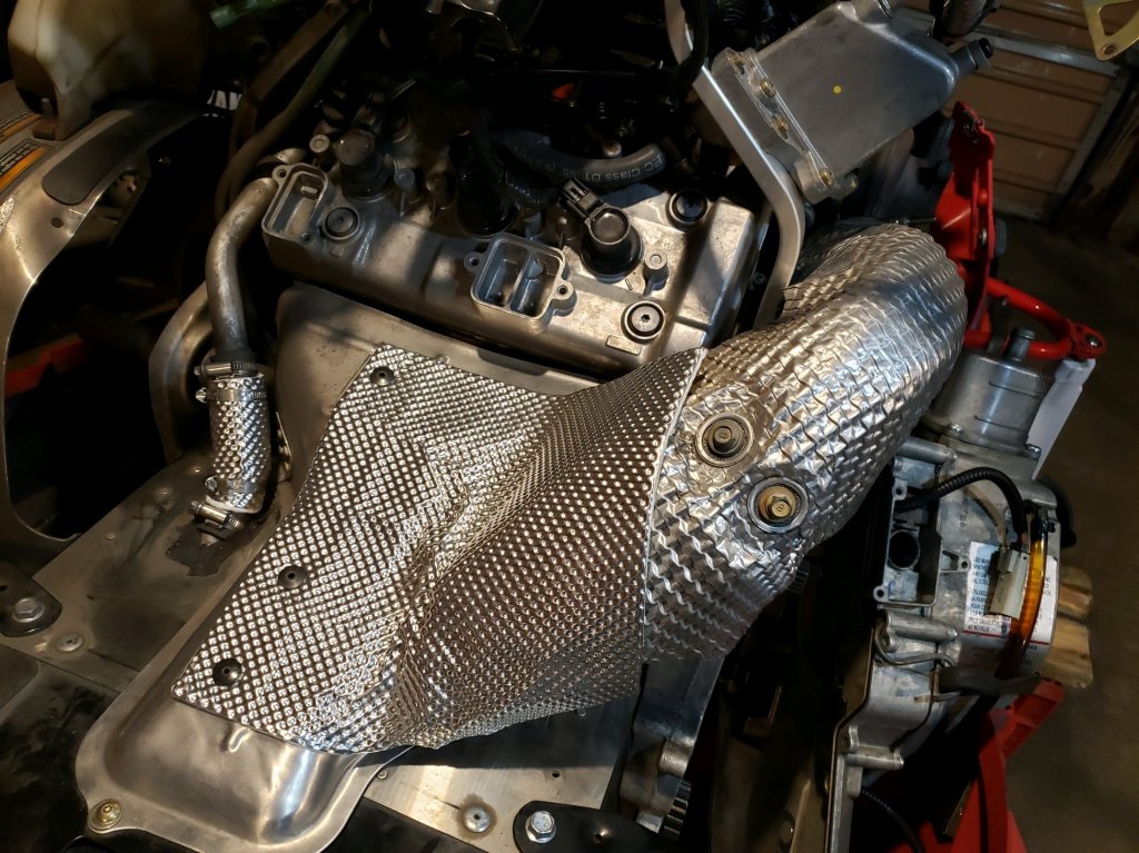

Hey Bob. Wondering if heat shield you put on is still working for you? Other thing I see is you installed it with the shiny metal side UP. Guessing you did this so it was not metal on metal? I have this same stuff and doing a mod, and was wondering if this set up is holding up?I would suggest protecting the cooling hose from header heat.
The heat protector suggested by KnappAttack in this thread is what I have used and it has stood up well.
Looking for a Mid pipe heat shield
Looking for a used or new mid pipe heat shield. I got 10,000 miles out of the original but the eyelets finally came out of it. Don’t really want to spend $200 for a new one but…ty4stroke.com
Thanks
Yes I installed it shiny side up. The proper way is to have the metal side to the heat. I never really considered the orientation when I installed it and I installed shiny side out mainly for aesthetics and luckily it is standing up well. The extra shield does not touch the header and there is an air gap between it and the header and also hardly touchs the tank.Hey Bob. Wondering if heat shield you put on is still working for you? Other thing I see is you installed it with the shiny metal side UP. Guessing you did this so it was not metal on metal? I have this same stuff and doing a mod, and was wondering if this set up is holding up?
Thanks
As you can see in this old thread others have installed the shield in same orientation.

TY.. Anyone putting any kind of high temp locker/?? on header nuts?Yes I installed it shiny side up. The proper way is to have the metal side to the heat. I never really considered the orientation when I installed it and I installed shiny side out mainly for aesthetics and luckily it is standing up well. The extra shield does not touch the header and there is an air gap between it and the header and also hardly touchs the tank.

Or just clean up good and torque to 20?

I just put the manifold bolts in the way they were from the factory at factory torque specs.TY.. Anyone putting any kind of high temp locker/?? on header nuts?
