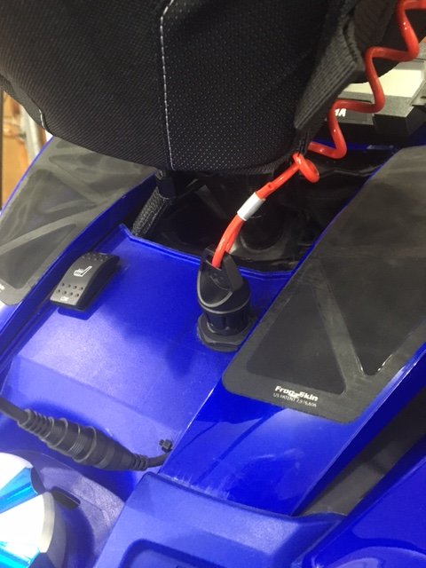

has anyone got rid of their teather? i know i will never use it , would like to bypass it n get it gone, plug hole , join wires? is this possible?
What's the year on the sled? Looks like a 2020 model, which means the tether plugs into a connection right under the spars that come up from the fuel tank. In order to bypass it, you'll just need to order the bypass plug. I have the part number at home I can send your way after work.
sideshowBob
I wonder why you would want to eliminate it?
I installed a tether on my 2019 X-TX LE for snow drags ect and I found when trail riding it got in the way occasionally so I bought a second tether chord/cap and trimmed it down as far as I could so it didn't interfere with my my handle bar bag ect.
I just keep a proper tether in my handle bar bag for when I need it.
sideshowBob
Pics prob better explain it

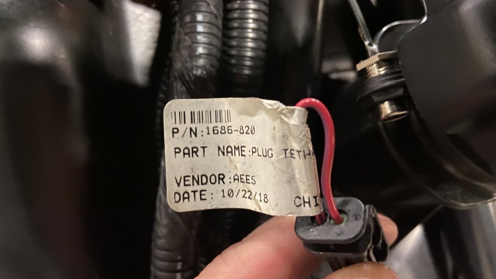

As much as really do not recommend bypassing a tether, the earlier sleds did not have them. It is a normally closed system, so connecting the two wires should do the trick. Test it of course before making permanent mods
Totally forgot about replying to this after many miles and smiles on my first trip this season to northern Maine (-20°F temperatures BEFORE the wind chill might have frozen the brain cells dedicated to getting you this).
The part number is 1686-820 and you can get it from Arctic Cat (the part is $8.52 USD).
