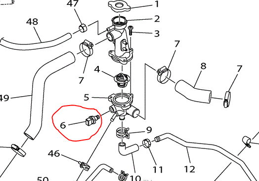

Good info, mine never went that low in temp and never lost power, I stopped a few times and checked heat exchanger and it always had some warmth there but never real hot so I knew it wasn't anything real major as the sled ran normal. Where is temp sensor located?
Turtle
- Feb 27, 2006
- 1,340
- 357
- 1,288
- Marathon, WI
'07 FX Phazer GT
It's located right by the theromstat.Good info, mine never went that low in temp and never lost power, I stopped a few times and checked heat exchanger and it always had some warmth there but never real hot so I knew it wasn't anything real major as the sled ran normal. Where is temp sensor located?
