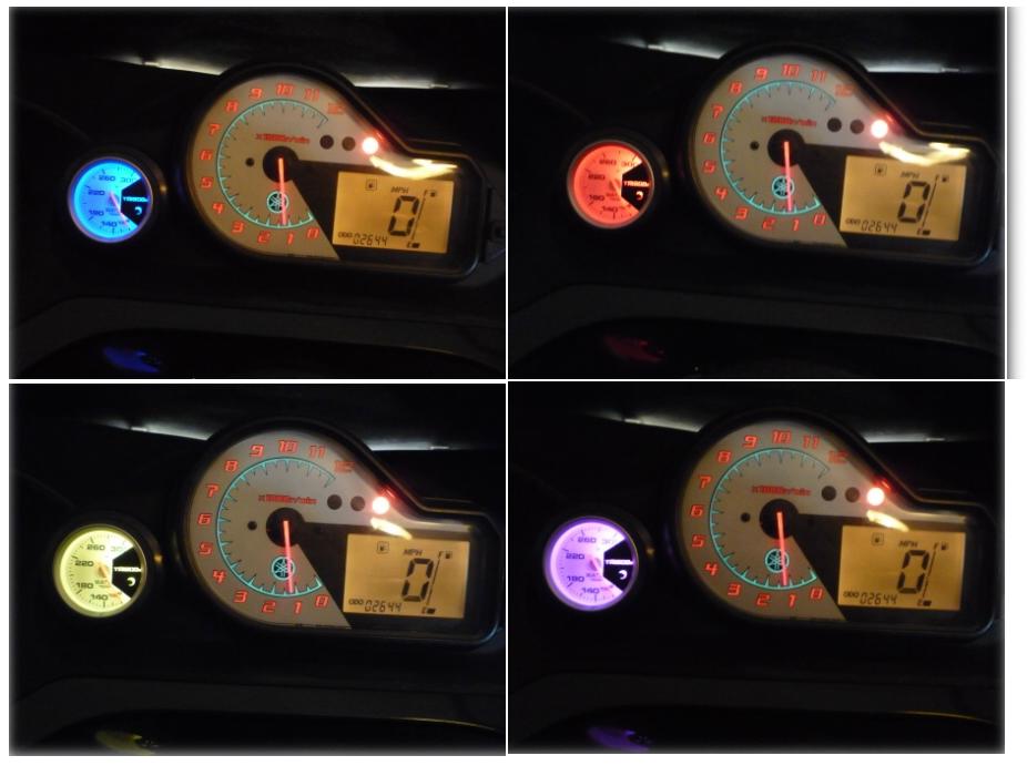

One of the other posts on this site says that it comes on at 210 F. I'm seeing average operating temperatures between 160 and 180 depending on conditions.
What kind of gauge are you using and can you post a picture.

It's an automotive unit and the brand name is Trisco but you should be able to use any 12v gauge that will fit your panel. I like this one because it looks stock and has different color LEDs for riding at night. Then I bought a kit from Royal Distributing that comes with the right size union for splicing the hose and a 1/8 NPT port for the sending unit. All this cost about $70 but you can find kits on here that come with everything- they just might cost a little more.
