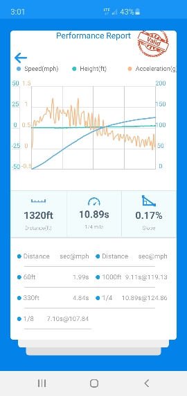

Played around on the lake today testing 3 secondary springs, stock yellow, dalton black orange gen 1 and Ulmers red.
Setup as follows;
TD 290 tune
Dalton black-bronze primary spring
Qay70s @77.4 grams
Stock 35 helix
8JP
24-37 gearing
All my passes very very close but the best passes were with the Ulmer red @ 9-1 and the dalton black orange @ 6-2.
Ulmer red @ 9-1
Dalton black orange gen1 @ 6-2.
What I found interesting and maybe someone knowledgeable can chime in is the 660' and 1000' speeds were higher with the 24-37 gearing than they were with the 22-37 gearing yet the 22-37 hit 130mph 200-300' faster than 24-37.
I tried the black orange gen 1 @ 6-1, 6-2 and 6-3. The Ulmer red @ 9-1 and 9-2 and the stock yellow at 3-3.
I'm swapping back to 22-37 now and looking forward to see what speeds the Ulmer red will give me.
My rpms were a tad high at 91-9200 so I'll need some DTYA1s with I think 79 grams or so.
Boost was steady at 18 PSI give or take.

Looking good, I think if you can hook up better you will be very close to your 130mph target. Looking at the G chart, you are struggling for traction until 25% into the pass.Played around on the lake today testing 3 secondary springs, stock yellow, dalton black orange gen 1 and Ulmers red.

Yes you are probably bang on. I could feel my new track stretch the more passes I did so it needs to be tightened some too. Overall pretty happy. Its hard to gain once your at those speeds.Looking good, I think if you can hook up better you will be very close to your 130mph target. Looking at the G chart, you are struggling for traction until 25% into the pass.

That little bit of loose snow can play a big part in speeds. Head out at daybreak tomorrow with things froze up, you may be awfully close to 130.
RAMSOMAIR
and drop that front end waaaay down, good for 2mph.

Higher gear = less torque to track at line = less track spin with price being paid (slower acceleration) once traction is gained.
Lower gear spins more at hit but once traction is gained, accelerates at higher rate than 24/37 to achieve higher speed in less time.

I'm going to start playing with suspension a little more now. Drop the nose and maybe pull the limiters a hole or 2. I think I'm at the 2nd hole now.and drop that front end waaaay down, good for 2mph.
