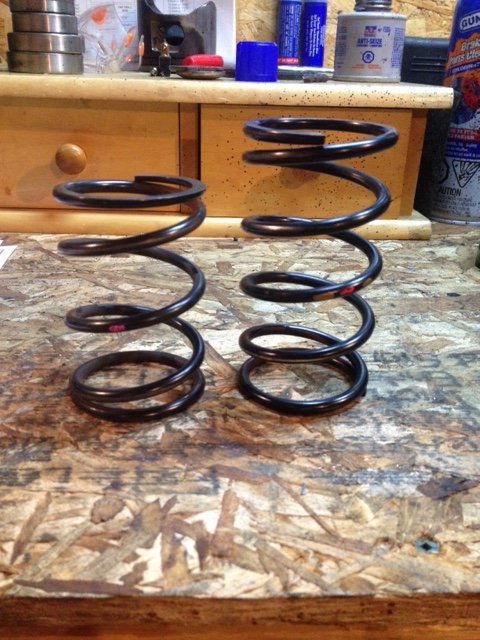

Nice testing and thanks for sharing... What exhaust? And assuming 8jp... Can you post a pic of Ulmer pink? Sounds similar to thunder orange primary?
- 2,763
TD super quiet, 8JP belt. The ulmer pink is short, apparently it's a 30/90, but I'm not sure if it's measured the same way Dalton does.
Ulmer pink next to the stock spring.

I would try one of these with more weight in the weights. That pink spring is too short. Engages too soon for good trail performance with that helix and the small primary rollers in the drive clutch. Just my opinion. I tried some lesser pretension Yamaha springs which lacked low end zip.

I have tried the dalton black/teal and I prefer the ulmer pink. Engagement is 3200 and like I said I believe it to be stiffer than the 30/90 ulmer told me it was. I honestly didn't notice much difference performance wise between the springs other than the ulmer pink is way easier to install.I would try one of these with more weight in the weights. That pink spring is too short. Engages too soon for good trail performance with that helix and the small primary rollers in the drive clutch. Just my opinion. I tried some lesser pretension Yamaha springs which lacked low end zip.
