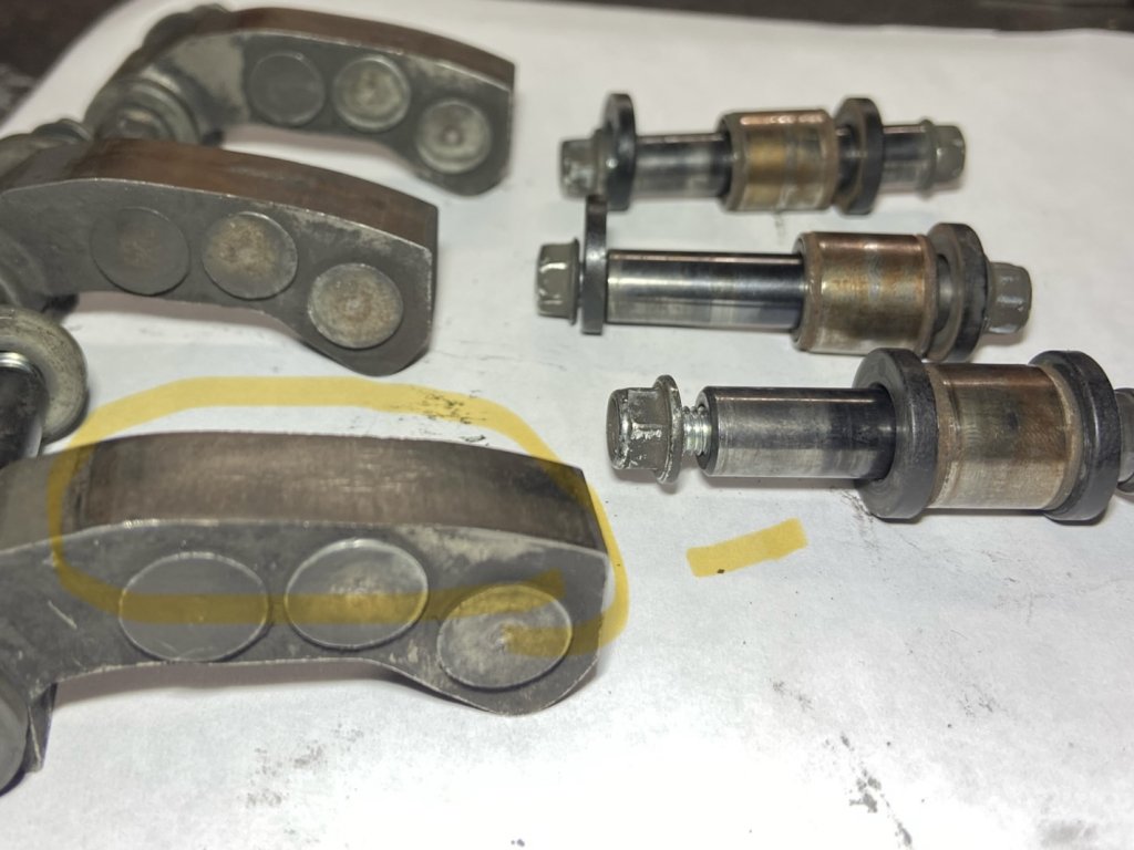

It’s the first time I’ve touched the clutches (other than changing belts) on my 2017 Sidewinder with 9’200km on it. Of course I had the flat spot secondary rollers and 1 primary roller that wouldn’t roll which wore the weight down. The first few seasons I never blew any belts but the last couple I started snapping new belts (always running 8JP) when off and back on throttle. I checked my offset and it was 59 but I’m feeling the flat spot secondary had a lot to do with this (pic attached).

Last note, you really need to spend more time in maintenance. I don't think I've ever seen a roller that worn out. Makes me wonder what the primary parts looks like? Just saying...
The yellow highlighted area is where the weight was wore down about .005” from the one roller that wasn’t rolling easy. The rollers aren’t that out of round.
Yeah the clutches were neglected but I never had too many issues until last season or so.

I see...pull the pin that's inside roller, look down the roller. See if it's ovaled out.They look like this:
View attachment 174690View attachment 174690
