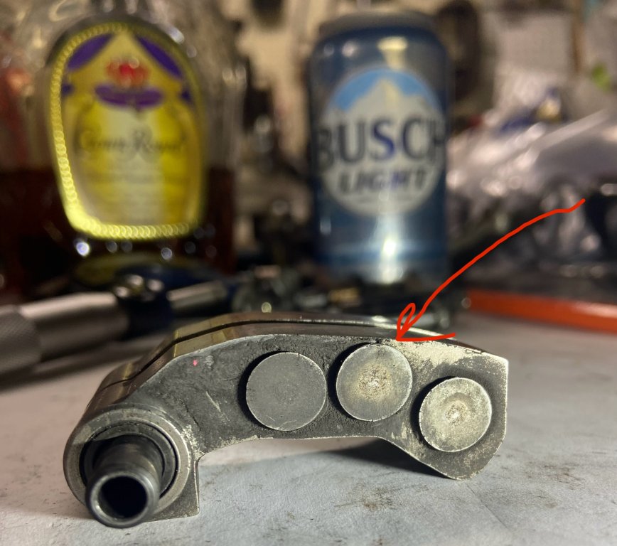

Put the stock helix back on and send it. No big problem there. For that matter, I don't see the weights wore from the pictures either. You say .005" of wear on one of the weights, how did you drive at that figure? All three look the same to me, but no way to see .005" of wear. Set all there of them side by side and sight down them.
Looks to me like you can just replace the primary and secondary rollers and call it a day.
Just looked at the pictures again, that flat spot on the secondary roller is not even on the updated rollers, that is an original roller, they flat spotted rather quickly, surprised you got any miles out of them myself. I just dont see the need to replace that set of weights at all unless the bushings were worn, same with the helix, no reason to replace it.

You can kinda see what I did in the pic, I made a measurement between the weight and the edge. It also had a burr..Put the stock helix back on and send it. No big problem there. For that matter, I don't see the weights wore from the pictures either. You say .005" of wear on one of the weights, how did you drive at that figure? All three look the same to me, but no way to see .005" of wear. Set all there of them side by side and sight down them.
Can see the other weight behind it. Think that’s why I was blowing belts last season?

Looks like there may be more than five thou. That's where they start to go. Hard to tell without having them in front of us in hand.You can kinda see what I did in the pic, I made a measurement between the weight and the edge. It also had a burr..
That pic looks more like the weight is worn, put the third weight beside it, sight down it and you'll know for sure. Seeing this it could possibly be worn. The reason it could have been blowing belts is the clutches were not operating smoothly with the skidding & binding rollers.

Same thing happened to me.So in this case what it seems happened with the Yamaha roller is that the bushing worked its way out a little bit as you might be able to see in the pic and that causes it to bind up. I wasn’t able to roll it with my fingers at all. This caused about 0.006” to wear off the weight but I’ve checked the roller with a digital caliper and micrometer several times if it is out of round it isn’t by much more than 0.001”.
OD was 14.44mm btw, at over 5000 miles with zero maintenance. ID 9.22-9.24mm
