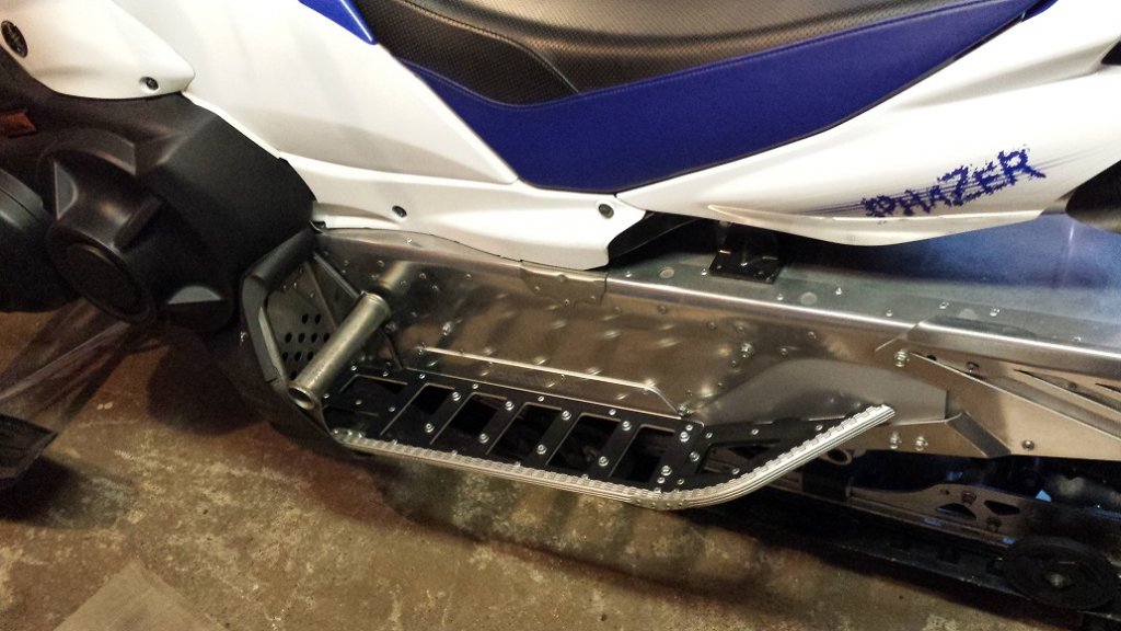

The tunnel close out panel helps, but even on my 09' that came form the factory with the rear of the tunnel closed off, ice build was an issue. Once I added Mountaintech boards ice build up has been no longer an issue. G.B.
I understand your point of view for the running boards but do you still not have ice build up in the tunnel in spite of it being closed off? I closed my 07" tunnel openings and I still have ice build up in the rear and along the sides. Those running boards are pimp and I often wonder if I should take a hole saw to mine to improve the deep snow evacuation without sacrificing structural rigidity.

Maybe? Since you can now pick up Nytro XTX's for under $4,000 right now. When I bought my Phazer 5 some years ago they were 3,000 more than a Phazer. I have ridden Nytro RTX and XTX's and while they have more power they are not as easy to throw around as a Phazer is. A Phazer I think is some 60 lbs lighter and the narrow seat makes it easier to hang off in the corners and gives you leverage to throw it around. Anyone considering a Phazer should ride one first as they are really different than most sleds out there. I love my Phazer especially after I long tracked it and added a bunch of mods. Is is 10x better of a sled than stock. My modified Phazer is ideal for how I ride about 80%. About 20% I wish for more power. G.B.Wouldn't the individual benefit more from buying a Nytro? Suggesting that after buying the sled, then having to sink more money into rail extensions and a longer track that is still going to be turned by a wee 500cc engine, it probably would be more beneficial to just spring for a Nytro..then you get the longer track and the extra power to spin it. You could also stud the stock track like I did, keeping in mind that it was originally intended to be a trail sled not a crossover. I do agree that if the stock hacksaw came in at least a 1.250" it would not spin as much.

- Howell, Michigan
These Mountaintech boards are killer! They are the best ones you can buy. Super strong and fit like factory. My 09' has the rear section of the tunnel closed off from the factory. The front is still open. There is no ice build up on the boards with the Mountaintech running boards. The only ice I still get is a small trail of ice down the sides of the tunnel near the end of the gas tank and the front of the seat. Its not much but from time to time my pant leg sticks to is, haha. G.B.I understand your point of view for the running boards but do you still not have ice build up in the tunnel in spite of it being closed off? I closed my 07" tunnel openings and I still have ice build up in the rear and along the sides. Those running boards are pimp and I often wonder if I should take a hole saw to mine to improve the deep snow evacuation without sacrificing structural rigidity.
