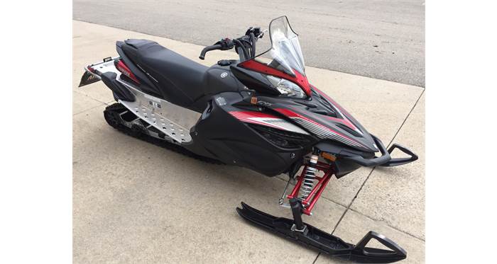

Thanks for the feedback. I'll stick with the 1.25".
Found a like new '15 X-TX with under 900 miles. Working out a deal.

Fairly confident based on your riding conditions you will not be happy with the Tuner skis, so consider some options before you ruin a sledding season fighting with them like I did. Longer track and studs will make it even worse, jmho.

whitedust1
Nice sled but also think you should ditch the tuners for single keel stockers with aggressive snow trackers and rail the trails.

I agree 100%Nice sled but also think you should ditch the tuners for single keel stockers with aggressive snow trackers and rail the trails.
