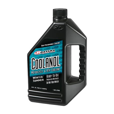

I have no affiliation to Maxima but this is quality coolant.. No mixing just straight in from bottle. Good for -34 . 50/50 Mix.I agree....Just thought it was odd. For a moment a thought a may have fractured the head gasket in one cylinder. Still running very well. I'll follow your advice in regards to drain. And pull plugs to see what's what.
Since it's the end of the season I'll replace the thermostat and pull the water pump for inspection

Thanks, jonlafon...I'll look for it as I button things up.
