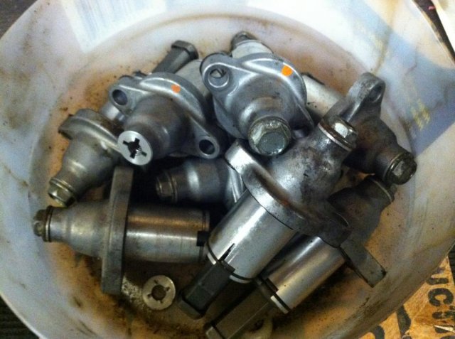

Follow the correct install procedure and it won't jump. I've had a little experience with this over the years and the first few I did didn't go all that smoothly either.
A few of the tensioners I've changed

Awsome. This makes me feel better. I finally got the sprocket lines and marks all lined up. I'll zip tie it to check the valves. And cut them and put the cover on.
Thanks grizz. I'll learn the tricks. Other then this the build has gone real well
