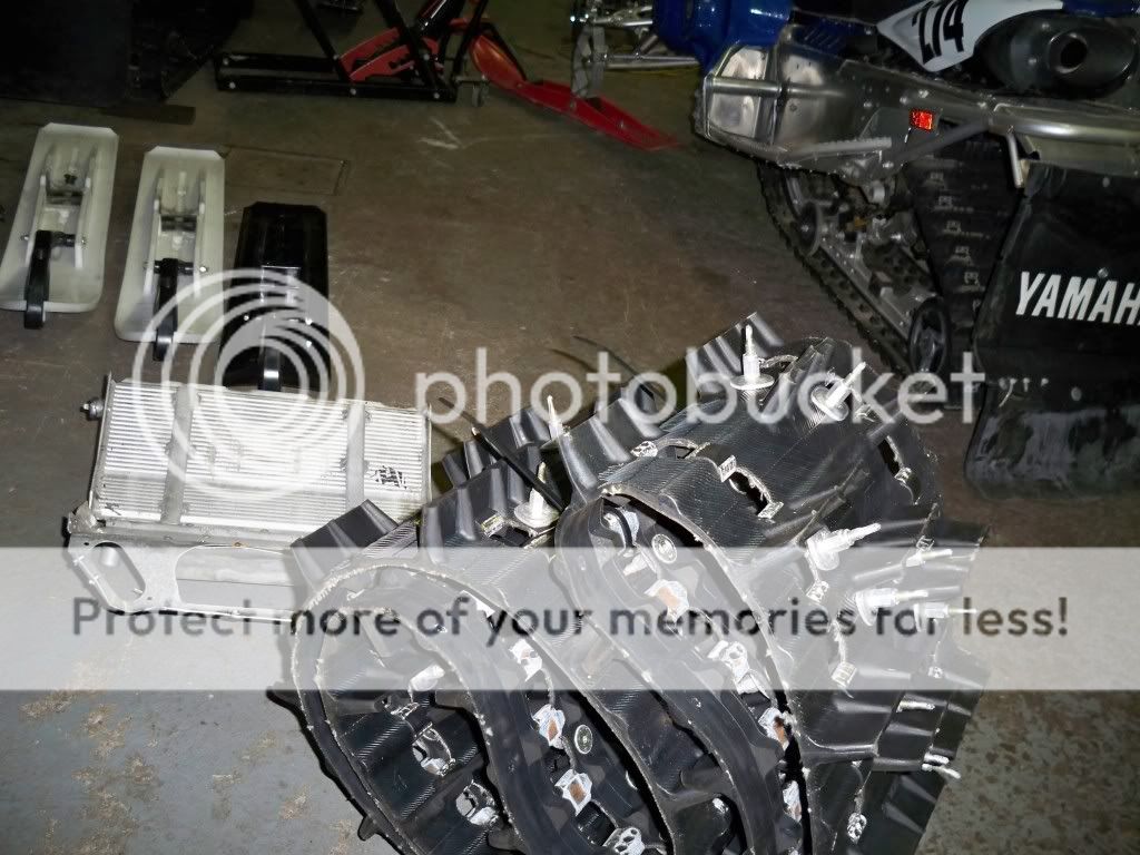

hey all i was given a camoplast 9076r snox track its a 1.75 lug it also had woodys snox studs which are 1.860 in size
my race sled that they are going on is a 2010 nytro rtx se
Im going to use the wahl bros extrovert drivers with a 2.52 pitch 8 tooth i beleave
Whta i need to know if this setup will clear my tunnel and heat exchanger or what mods need to be done
all advice is greatly appreciated once again
Pic attached
Pic attached

u may need a rolled chain case but to hard to tell with out seeing it.

I know it fits it was one of ian hayden or steve taylors spare track and was on there sled last year , they are just already gone for testing then to duluth and we havent been able to get a hold of them, i figured someone on here would be knowledgable with the nytros as i do not have much experince with them as we raced phazers all last year, i could tell you the ins and outs of those things. 1.75 track clears no issue on the phazer

u may need to go to a 7 tooth drive. I just think that the studs will hit something. With the studs the track is almost 2" tall, so like a Nytro MTX u may need the 7 tooth drives.
yammi4ever
In my XTX I have a 2" track in with no protectors and 9 tooth avid extros. I would guess with your 8 tooth you will have room, but if you don't you could notch the track a little where the protectors go.
rcguy
I plan on running a 136 1.75 this year, probably doing the change next days off but anyways, ive been told that the best way is to just take a grinder or dremel and take the protectors right out(but be careful) I will send some pics after next weekend if you want to see how it went..

Hmmmm, never seen a stud pattern like that. You will have to remove the front prtectors, with a 1.5 track and stock drivers there is only 1/8 inch of room.

Snox used to be limited on the number of studs, so they all had a few rows with only 1 instead of 2.

maxdlx said:Snox used to be limited on the number of studs, so they all had a few rows with only 1 instead of 2.
Yeah I knew that but I have never seen a scratch pattern like that before, I am also suprized they don't run double backers with a large stud like that......maybe its against the rules.
