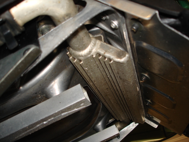

shawnj
On my LTX with a much tighter track tension than called for I mashed my rear heat exchanger on normal trail riding, no jumps. I have 1.45 studs I think. I put some hyfax on the existing tunnel protectors to help this problem. So far so good but afraid to take any "air" in case of disaster. Not quite as fun tho.

shawnj
Ya. I loosened it, but thinking on tightening it back up. I know the studs scratched the frame under the exhaust a bit too and also mashed my rear heat exchanger, but not sure if the extra protection would completly stop this or not>> HMMMM, what to do,.....I guess it will be more of a preference thing for me now. Really appreciate all the input as usual. Thanks all.big_red1a said:bobber said:I've been curious about track tension as well since changing out slides a few times. Asked a few times and have been told to run on the tight side due to having 162 1.375 picks in the track and at higher speeds the ballooning track would damage the exhaust. Anyone have experience with such a set-up?

bobber
After some nasty scarring on my rear cooler I installed larger protectors (thicker hyfax) on my rear cooler as well. Track has always been adjusted to factory spec and at times I still notice there's a new scratch on the exhaust. Would like to be able to run a bit looser if for nothing else but to let the machine 'coast' better but have to run tight due to the studs, which I will not give up.
