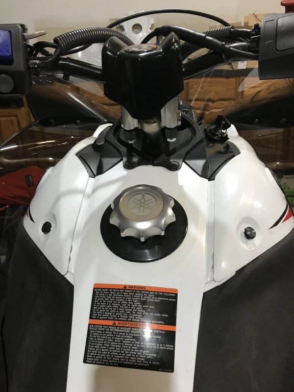

Trail Tank A+
Looks great. It was the single best upgrade i made to my Nytro. Totally changed everything. Enjoy the long runs now.
MS

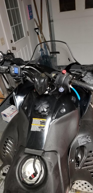

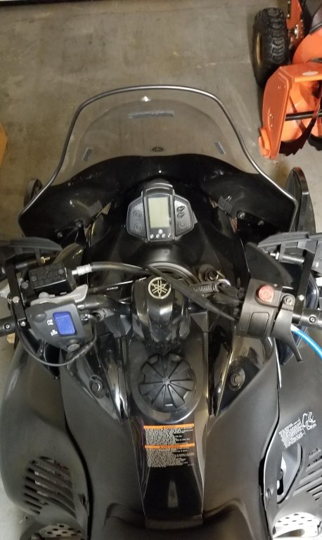

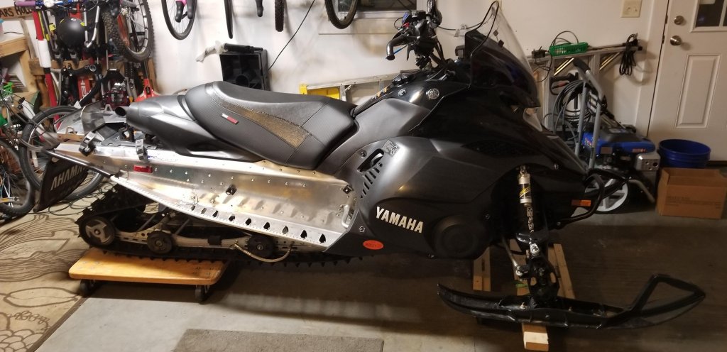

Thanks man! I'm really impressed with it so far, way better fit than I expected. Glad to hear some more good reviews. Its gonna be a game changer for me I think. I hated being the only guy in my group needing gas at 90 miles. No more people rolling their eyes cause I need gas.

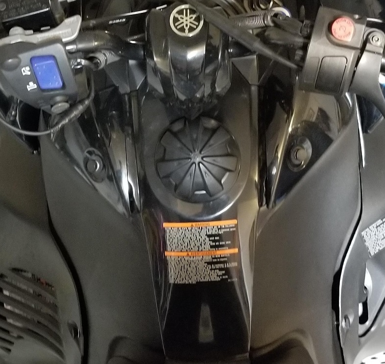

From your pics, the gen 3 seems like an improved mold! Looks great. Nothing like hiding a few extra gallons of fuel in a trail tank! Mine is thumb screws, have no idea when the original buyer installed it so could be gen 1 or gen 2; maybe the mark shown in the pics below indicates what year. I checked for rubbing of wiring harness at front and against the frame and seems good. The body plastics are like a suit size too small when you put them on; required ovalizing the hood thumb screw holes so you can just fit them on. I found some silicon adhesive grease in the tank screw holes make them go in much better. When I bought the sled it was blue, you can see the blue plastics were a little rough on the cutting and required the extra edge trim. When I switched over to a black hood and tank cover last year along with the black WRP seat, I was very careful when cutting the tank cover so the saw only took the plastic tab and left the factory finish down to the actual tab I had to remove. I wanted to avoid having to put on any sort of trim on each side but you can see where the hood and tank cover plastics come together, it is not like a Yamaha stock fit but adequate. The first two pics show my first cut where I left more of the tank cover where the hood intersects, then my final cut were I removed some more plastic where the hood meets the tank cover. Really does not matter as I cover it all with a tank bag! The WRP does not exactly line up with the trail tank or the rear plastics either, even on the stock seat pan, but love the WRP riding position. Even with the trail tank, I still carry a 1.3 gal Mountain Addiction Jug on my rack for regular riding. When we hit the Maine North Woods (no gas for 175 miles depending where you ride), I am still short fuel so found a set of new Nytro gas caddie bags (SMA-8GL73-CD-DY) in Canada last year , hard to find. I plan to install them this year and use one for gas, one for gear or both for gas on the deep woods rides (11+1.3+1.25+1.25 gives me 14.8 gal). I can always borrow gas too as the new Doo's can take 2x 5 gal on their tunnels but I prefer to carry in what I need and avoid the Nytro limited fuel comments!

Seavey, I do like the slight tuck and better fit of the gen 3. I just went out to the site, fantastic they kept a Nytro model in production. It looks cleaner, closer to a factory alignment.
I think they guy I bought it from said it was a 2nd gen tank, the owner dropped $5000 to do the front/rear suspension, trail tank, luggage, rear rack, track, skis, windshield, etc. I inspected all sides and it is solid with only some surface scuffing at the frame rub points, no pinches harness and no leaks but I like the gen 3, look better and quick disconnects. At the front corner, the wire harness had rubbed through the first outer wrap layer and I pulled it back to avoid the rub and added some harness wrap at the wear point. Anyone that has a tank like this needs to pull it out and inspect for sure, some as you noted, may not be "seated" in place and rub and leak. I like the gen 3 releases, the thumb screws are tender, with gloves you can cross thread and over-tighten easily in the field. I put a tap and die and Hurst (BMW German) hinge adhesive spray grease on the threads and they are very predictable to put in and out. Discovery side note, if you are into lubricants for anything mechanical, this is the only lubricant product you want to own. I mean anything, I own a a few cars from the 60s and 80s and that is the hinge lubricant for the 530i but it works great on a Nytro exposed front end ball joint system, literally any other part needing lubricant. It dries a little and sticks; a synthetic adhesive grease residue remains after the deployment solvent evaporates, leaving a skin, really nice.

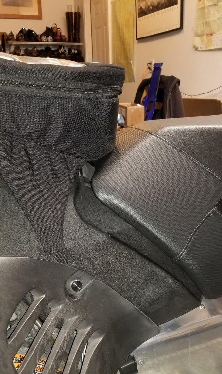

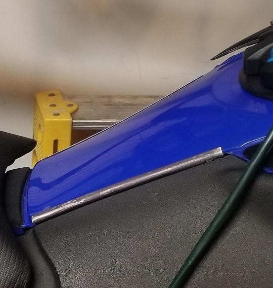

My sled is up North already waiting for snow but I found I had a pictures showing the my Trail Tank fit. The only fit issue I had on my 08' with an early gen Trail Tank is a V gap of the hood to the center gas tank panel. There are no hood gaps up around the front of the black console piece. The hood starts to gap rear of that as you can see in this pic. I had to open up the clearance holes a little in the hood so the thumb screws can be aligned with the nut inserts in the tank. The side view fits are great with no issue. Since most of the extra capacity of the Trail Tank is forward, the tank greatly reduces the air space behind the radiator. I had read of some cooling issues wiht this reduction in open space. So I shimmed my radiator forward and also added BOP extra Apex fan kit for peace of mind. G.B.
