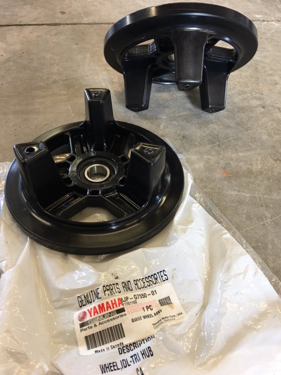

I doubt you'd feel much of a vibration from the tri-hub but it's probably time to replace the bearings in it before a failure occurs. All the idler wheels have replaceable bearings and the larger upper idler bearings have been known to fail also. There are a lot of things that can cause a vibration but if you're feeling it more in the footboards I'd be concerned with the clutch side drive bearing going out.

Just maybe because the wheels are held together by 3 spokes......Just maybe!
Tri-hub replacable bearing #6004

The tri-hub's 6004 bearing is also used in the smaller idler wheels. The two larger upper idler wheels use 6006 bearings.
