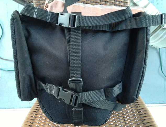

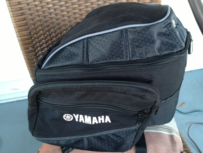

Hopefully other RS Venture riders who are looking for more storage space find this post helpful.
I couldn't find a trunk bag that's an exact fit for my 06' RS Venture so I made some minor alterations on an OEM Yamaha bag.
First I purchased the Yamaha trunk bag (Part no:10-SMA-8GC63-00-00) made for Apex, Vector, Nytro & Phazer.
I made some minor changes by purchasing three 1" side release buckles. Using the excess lengths of nylon provided with bag I added an extra buckle in the middle & installed two buckles on the front & rear. Then I simply connect to the bracket provided by the RS Venture (behind passenger backrest) & connect the front buckle around the passenger backrest for a perfect fit that's very sturdy & works like a charm.
I had the bag fully loaded all day yesterday & it worked great.
PS: It helps having an upholster as a neighbor.

I have the smaller version however I was looking at yours but they don,t give any dimensions in the catalog. Thanks for posting pic's. I can see how big it is now. I also have saddle bags. You can carry everything but the kitchen sink in those.
