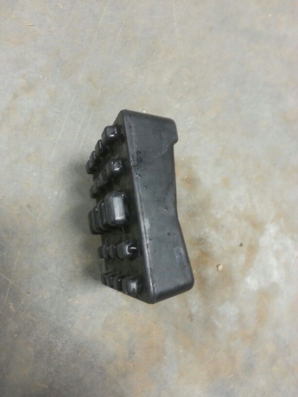

Installed Yamaha Tuner skis two weeks ago. Very happy with the results. Was running stock skis with 6 inch Duece bars and pushed pretty badly. Since installing the tuners has handled great. Very in love with this sled.
Installation was a bit tricky. The mounting holes on the tuners are a bit shallow for the cat spindles. There is a honey comb in the mounting area of the tuners that is a 1/4 inch thick. Started by removing this with a cutting wheel on the die grinder. Then ground off the knobs on the bottom of the viper ski rubber. Using the stock bolt and added an SAE washer to the outside and one in the middle of the ski to take any slack out of the saddle.
Works well for me and can get a set of tuners with 4 6 inch carbides for 250 plus tax.

Have the tuner skis on my viper too.Used the rubbers from a nytro and cut them down,works great.

I had the same problem installing the Simmons skis. Even though I bought the CAT version of the saddles it was a no go. I tried cutting down a spare set of cat sno pro rubbers and still to tight.
I had a pair of rubbers from an old polaris fusion that worked with no mods at all.
