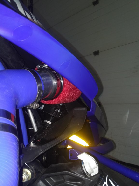

gpxsrx
https://ty4stroke.com/threads/ram-air-velocity-stack.147355/
Here is what i did. Mine you it was not turbo-ed then but is now and i am running the same set up.

That's where mine ended up after moving it around underage hood a few time until I got the coldest airOr you can go alongside radiator like Excell cold intake for na does. Has to be worth the trouble with all the hot air under hood.
