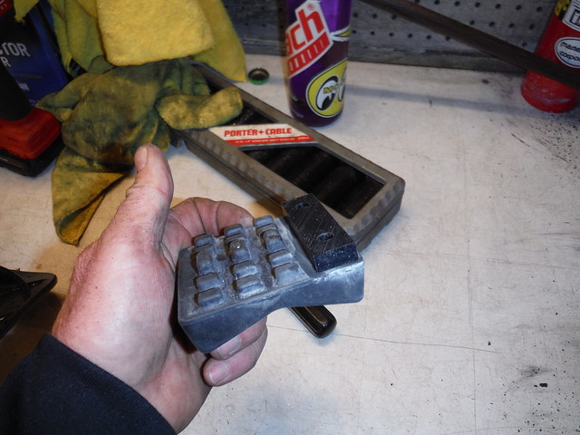

I've been very please with the Bergstrom system for many years.
Our past 3 sleds have have Triple Points, Ski Savers, and Shims.
With 1/16 - 1/8 toe out there is very little to no darting. Some hunting will occur with any system.
Carbide wear has always been very even & well balanced.
Last set of Triple points had over 5000 miles when I sold the sled. Still plenty of carbide, but starting to flatten out a bit.
Shim on the Arctic ProCross ski damper.
Ski Savers with Triple Points
Installing ski with shim on damper.
Comparing shimmed ski to un-shimmed ski.
If you have never tried this system you're missing out. Pretty much slot car handling on the trails.
Excellent carbide life is bonus material.
