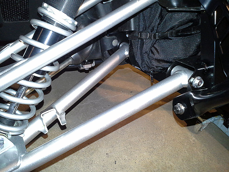

Where did you find those bolts for the sway bars? Do you happen to remember? It would help me out greatly!Now I'm probably done fixing all the errors the local Yamaha store made on my sled.
Done with the sway bar disconnect thing now and will try it out this winter.
I think I can go from connected to disconnected in about 30 seconds.
and how it looks while disconnected from the A arms.
I'm also thinking of making a cargo rack on the back of the tunnel or I will go with the Rotopax system just to bring with me fuel. But they are expensive here in Sweden, about 160 USD for the 1 gallon gasoline pack.

The ones with the looking pin thru the end of the bolt? I drilled them my self. Just ordinary bolts with a hole.Where did you find those bolts for the sway bars? Do you happen to remember? It would help me out greatly!

Oh really? Could you not find anything like that or did you do that just because you could?The ones with the looking pin thru the end of the bolt? I drilled them my self. Just ordinary bolts with a hole.

I did not think of anything else. Had everything done in two minutes.Oh really? Could you not find anything like that or did you do that just because you could?
