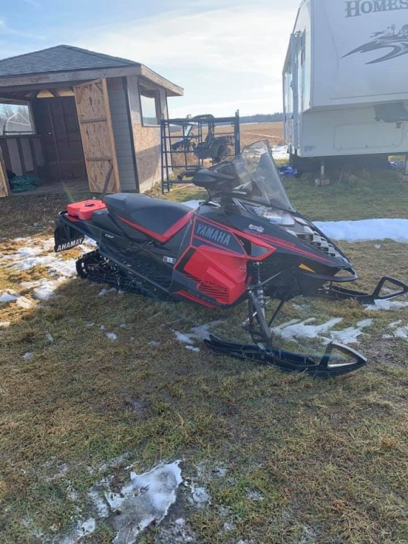

that looks like a LTX DX

I can't read the tunnel length, but if it is 129", then it is a 2016 RTX DX , an upgrade over the standard RTX with the high windshield and front coil-over shocks. I am not sure if it came with the heated seat? If it is priced like an SE, then assuming everything is in good shape on it, it is a little bit of a bargain!

Turns out its a LTX DX.

The picture is a LTX-DX. It comes with larger windshield and heated seat. Lengths were 129 and 137.
The STX-DX is similar in colour, comes with Fox floats, large windshield, heated seats and built in saddle bags. Lengths were 137 and 146. 146 even had that extra built in gas tank and storage.

RTX is the 129, LTX is the 137.

In general Rtx is 129 and LTX 137 for most years BUT the STX is variable, my 2015 is 141, some years are 146 and others 137.

Looks like the same sled I have....2016 STX DX. Hard to see some of it, but a STX DX 137 should have a tall windshield, mirrors, heated seat, and 1.6" trackHi. I was wondering if someone can tell me what this 2016 Viper model is? I am considering buying it but it is listed as an SE but not sure if thats an error
