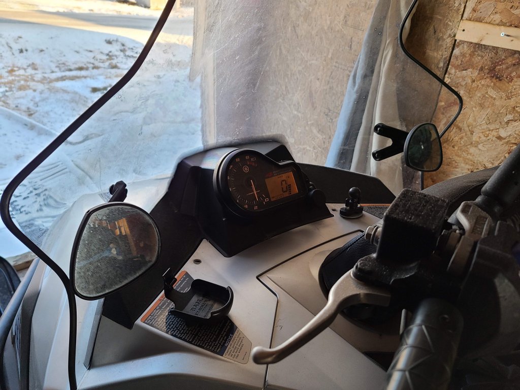

Good Day! On the VK PRO Mods of all the mods I have done the exhaust rerouting has been the best. Keeps the tunnel clear with minimal ice build up. That is at average riding conditions of -25. The wider ski skins give stability and the marginal snow kit was well .......marginal. The extra bogey wheel on each side was not sufficient to eliminate wear on the slider. So the marginal kit was a bust. I increased height of windshield with extension. Built a storage box for the rear. Installed ram GPS mounts for the SPOT and Handheld GPS. You can see in the photo a 1/4 inch drilled hole into the dash to bring heat up on the windshield because of icing. The noise from the clutch is a bother. Warm sled to drive, good on gas.
