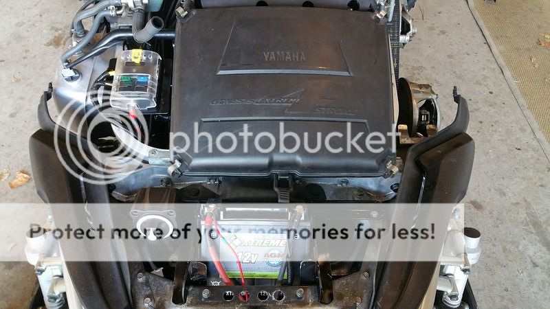

Starting to get my new to me 07 VK Pro set up for the coming winter season. 95% of the time the VK pro will be used for ice fishing across Northern Minnesota and Lake of the Woods.
This is my first 4-stroke sled, my previous sled was a Ski Doo Grand Touring 500. Not having another option to start the machine makes me a little nervous, especially when I can be 20-30 miles from civilization on Lake of the Woods - so I decided to rig up a dual battery set up. I thought about just lugging around a jump pack, but I wanted the self contained ability to seamlessly switch to a back up battery.
There was plenty of room for a second battery in the nose, so I fabricated a bracket out of some heavy gauge aluminum channel. The entire bracket can be removed with 2 bolts. Hopefully it doesn't obstruct or mess up any of the ventilation to the engine. I made sure the duct on the right side remained exposed. I have another battery cover on order that should fit right over the second battery to protect it from any snow that gets into the engine bay. I also installed a waterproof switch from Blue Sea systems that allows me to switch between battery 1, battery 2 or to even combine the batteries (it also has an off switch).
While I was at it, I also added a Blue Sea Systems fuse panel next to the air box to make install of accessories much easier.

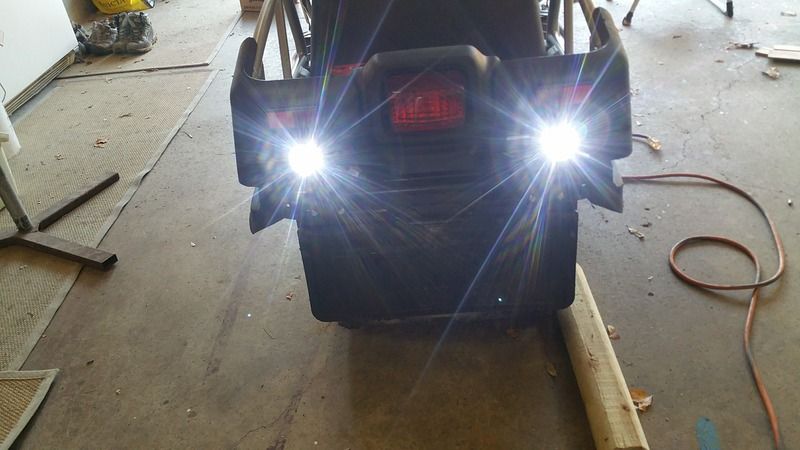

The plastic on the rear bumper was kind of mangled. So I trimmed away the damaged parts which left the lower bumper railing exposed. So I mounted two Scotty rail mounts, and attached some LED flood lights. The lights and wire harness came from super bright LED's, they can be turned on and off via a little key fob remote. This makes it easy to see what you are doing when drilling holes and also during set up/tear down of my portable ice fishing shelter.
In the event I need a jump start, or need to jump start someone else, I ran heavy guage wire up to the handle bar pad and installed a quick connect on a set of jumper cables.
I have a two bank charger to keep the batteries topped off, I ran the wires from the batteries to the handlebar pad and installed some quick connects so I can easily hook it up.
I still need to mount my GPS and depth finder, and also figure out where/how to mount my ice auger.
