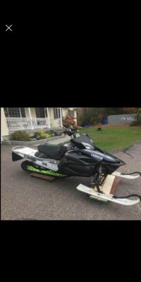

Wow thanks for the great feedback kinger. The sled has a skidoo RS seat that’s nice and firm. I’m 6’1 and it feels like a good riding position with the riser. I have a mountain mod seat to try also that came with it. It’s got the curve skis on it. Should be a decent setup. Here’s a pic of the whole sled.

Dude that is crazy! You got a sweet deal, it looks like that is a ski doo tank which will be amazing, because it moves all the fuel under and back and makes the sled so much more playful. Ditching the stock gas tank in favor of a doo tank is one of my top mods. Completely changes the sled to 'feel' like a 100lbs less. No joke. When was the chaincase gone through last? If you ride hard in moguled out trails I completely stretch out the chain in less then 1000 miles. Its annual maint for me to swap out the chain. Also use 75W140 gear lube, I found it helps a lot, I got almost 2000 miles on that fluid in there. Its thick and heavy probably costs a little power when cold but you have more then enough to make up for it.Wow thanks for the great feedback kinger. The sled has a skidoo RS seat that’s nice and firm. I’m 6’1 and it feels like a good riding position with the riser. I have a mountain mod seat to try also that came with it. It’s got the curve skis on it. Should be a decent setup. Here’s a pic of the whole sled.
