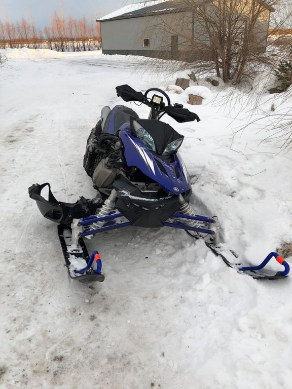

I am guessing that when the donor sled went nose first into the pole the abrupt stop hurt the gear reduction??
The donor sled hit dead on the front bumper and broke both bulkheads clean off. The steering linkage was the only thing hold the frond clip to the rest of the sled.

Pics of the donor sled. The entire font end was being held by the tie rod ends. Once those were removed the bumper thru to the A arms came off in one piece.

What did he hit? Strange you can't see any damage on skis, bumper, or nose of sledPics of the donor sled. The entire font end was being held by the tie rod ends. Once those were removed the bumper thru to the A arms came off in one piece.
View attachment 154592 View attachment 154593
He hit a pole like this
Yikes!
I hope he was OK
I thought he maybe got hit on the # 1 by a car
He was ok.
