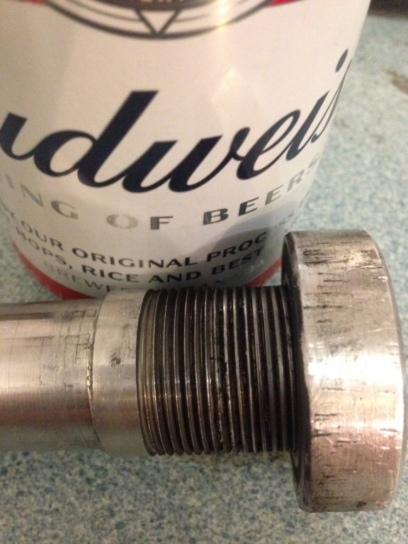

I have the osp adjuster. It works like it's supposed to.
Here's the problem. The threads go bad on the adjuster after a lot of use. My adjuster worked the first year fine but the second year it seized up. The threads roll over. I believed ita caused by the nylon black washer rolling up and down the threads.
I think this issue will happen on any aluminum adjuster

Very interesting. I am by no means putting down osp thunder hurricane td or anyone that makes adjusters.I am curious as to what people say too. Maybe I can incorporate feedback into the final design of one I am making.
One thing that I notice on both those designs is there is a washer that floats. My current design has no floating washers.
But from my experience the adjusters are very nice for keeping up with belt wear . But there down falls are the threads rolling from either the floating washer or small thin washer added for belt removal and the allen head bolt stripping.
I would love to see an adjuster that you don't need to use the Allen key to turn the nut. It always ends up slipping out.
To change belt do you actually put the screw in and run it in or do you just spin the adjuster nut with the allen wrench in the clamp bolt?

The version I have does not have a bolt to push the clutch apart. You have to run the nut in.To change belt do you actually put the screw in and run it in or do you just spin the adjuster nut with the allen wrench in the clamp bolt?
The ones with the bolt have a thin washer to push against. It's does the same thing and rolls the threads during long term operation.
I used anti sieze on mine from day 1. 10000 mi on sled probably 8000 on adjuster and it still works great. I don’t ever use it for removing belt since it’s easy enough just doing it by hand. Joe are you saying the threads are rubbing the clutch? Maybe OSP made later ones bigger dia cause mine doesn’t rub at all.

Happened to my TP adjuster. I just cleaned with lite wire wheel and little oil and it loosed up fine.I have the osp adjuster. It works like it's supposed to.

No. I don't think they are rubbing the clutch, when the clutch floats the nylon washer is free to move on the threads.
It's just my geusse why the threads rollled like they did.
I had to change the belt last year up north. When I tried to change it the nut seized After trying to adjust the new belt. That's when i found the rolled threads.
Again I think the adjuster is a great idea for belt life and a very good product other then this problem.
