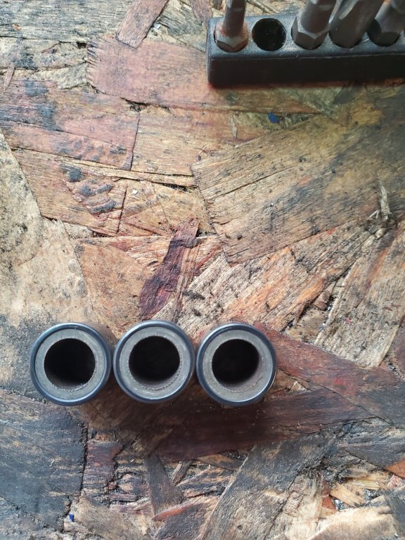

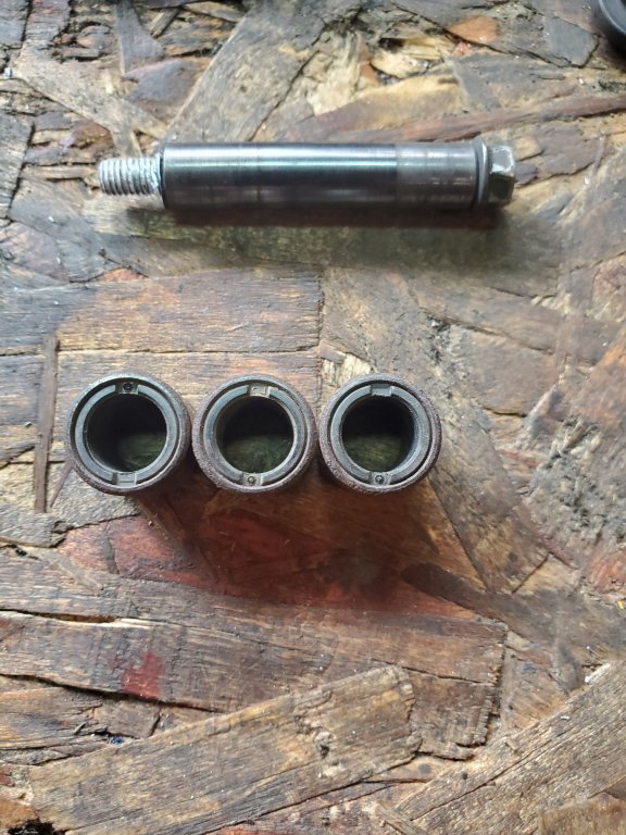

Here's my TP rollers after 3000km.
I'm tempted to try these old Nytro 14.5mm rollers I have laying around.

Please share with everyone the clutch setup that your bud is running. Which clutch is he running? I have asked for this information from you in 2 more posts and have not received anything in return.
(Please read this closely and this is for everyone) The extremely heavy weights with the heavy spring "IN THE SIDEWINDER PRIMARY" is what is causing ALL rollers to fail very quickly.....THE SIDEWINDER CLUTCH is the problem, not our rollers or any of our competitors rollers.
Extensive testing has been done and these are the facts from testing, reviews, racing, customer feedback and from all social media out there.
Thunder Products rollers have been in production for 17 years and now that the Sidewinder primary comes out, there is a roller problem. Think about that for a moment....
Next is, it's not a horsepower thing either as we sell the previous style primary to our high hpr customers and no matter what weights they run, their Thunder Products Clutching rollers are perfect after thousands of miles. Apex's that were running close to 500 hpr not having roller problems...why? Cause they aren't running a Sidewinder Primary clutch.
I'm not here to be in an argument with anyone, but I'm also not going to read something about a problem with our rollers wearing out very quickly.... when it isn't our rollers that are the problem, It's the Sidewinder primary clutch which has been proven time and time again by testing, changing over to the previous style Yamaha primary and proven results.
