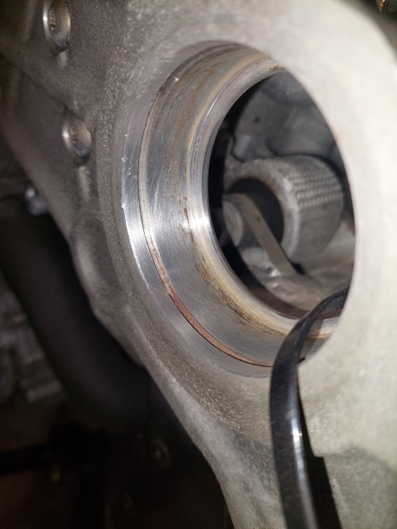

Here is the yamaha part # if you need a extra 1.5 mm to achieve closer to spec alignment.
This clip is used on all Cat 998 and yamaha used a clip on the shaft.
8JP-RAH06-00 this is not a official part # for the clip for that specific area on our sleds.(it's the same bearing clip as the top chaincase bearing )
