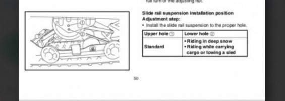

Hi,
Just bought a 2022 VK Pro 2. Id like to try different adjustments. Will dropping to this lower hole affect track tension in any way? Meaning, can i just jack it up and drop holes, or will it loosen the track and possibly need track tension adjustments after if i screw with it? Thanks

I have not made any such adjustments but would not expect it to require a track tension adjustment afterwards.

no it won't affect track tension, but to lower you should back off your tension and pull the torsion spring out of the hook behind the idler wheel and then drop down into the next hole makes it alot easier . just did a 2018 vk540v , which has the same rear design skid. keep in mind this will raise the ride height making the sled a bit more tippy! cheers!

Thanks. I was hoping it be just as easy as pulling the bolts and jacking it up. I dont have a garage and its still a bit snow packed in there.no it won't affect track tension, but to lower you should back off your tension and pull the torsion spring out of the hook behind the idler wheel and then drop down into the next hole makes it alot easier . just did a 2018 vk540v , which has the same rear design skid. keep in mind this will raise the ride height making the sled a bit more tippy! cheers!
Im trying to see if it can help it with some deep snow trenching. Truthfully, im slightly regretful of the purchase…It trenches pretty easy and im almost a bit worried now to ride it alone. I had to get pulled out twice. The snow is incredibly deep this year.
I had the dealer drop the limit strap to the first hole before i even rode it, im wondering if that is aiding in the trenching as well. Not sure what hole it came with from the factory.
My sled before this was a 600 ace tundra. Pretty much never got stuck. Two different machines, i know.

might want to try sucking up the limiter 1 hole as it might crawl up on top of the snow better. had to do this to a sled as it was trying to weelie on any throttle input.

Definitely was going to try that in a bitmight want to try sucking up the limiter 1 hole as it might crawl up on top of the snow better. had to do this to a sled as it was trying to weelie on any throttle input.

I just sucked it up a hole and took it for a ride. Ive got to say…. im fascinated an inch or so of strap length made such a difference. I honestly didnt think that little bit would change the characteristics that much.might want to try sucking up the limiter 1 hole as it might crawl up on top of the snow better. had to do this to a sled as it was trying to weelie on any throttle input.
Before, driving across the lake, it felt like a boat not on plane yet. Now, well, it runs level like a boat on plane. Ok…i still thought it would trench, so i took it over a snow drift that i got stuck in earlier. It crawled over. Again, im kind of fascinated lol.
Ive got hope for this thing now lol
