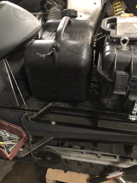

This week I have worked on my box for the back of the sled, and gas can as well. I really like these waterproof boxes that you can buy for dirt cheep. They are tough and they look good too. I had to install a few blocks on the box to shim it out so that the catches lined up with the rack. I also installed axe on the top of the box for on trail modifications. Then I put eye hooks on top so that I can tie extra stuff down.
I also found a really old gas can that fits the space well and holds 3 gallon but looked rough. So I searched up painting it and found info on dyeing plastic so I gave that a try instead. I am happy with how it turned out we will see how it holds up.
- 21,883
- 9,476
looks like your having a ball on this build!!

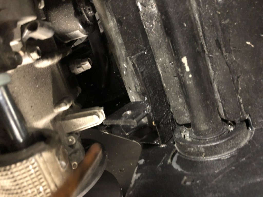

Lots of fitting and testing to make the steering work. This is way harder than figuring out the motor mounts. But I think I am getting somewhere the viper air box has a lower top and fits under the hood way better. I also gave it the treatment to allow more air in. Man is the viper air box really heavy, I am going to weight it compared to the nytro.
