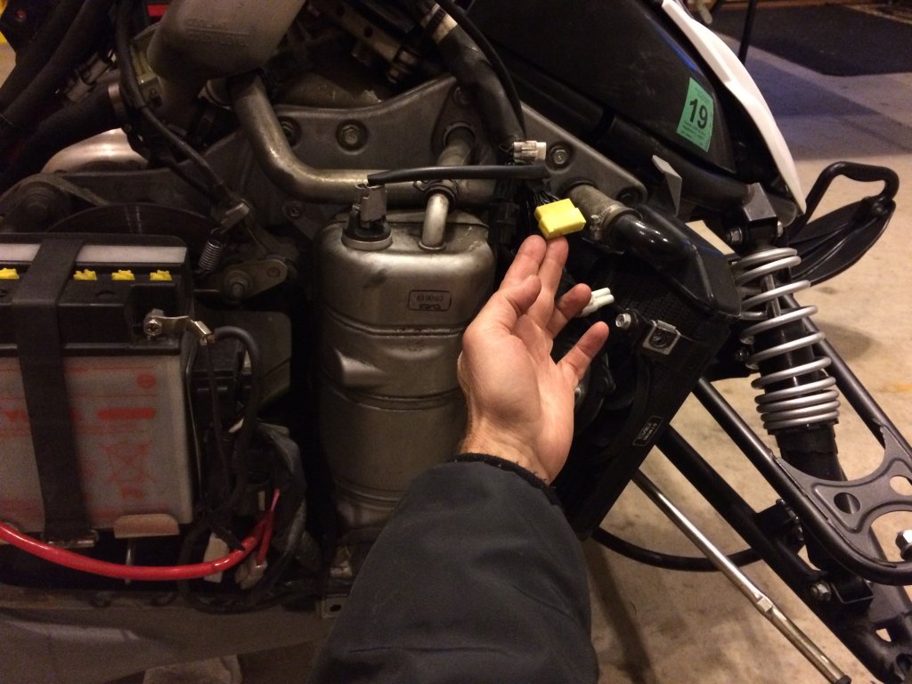

Last ride I encountered an error 81 and flashing engine light. Shut machine down and restart and it goes away for a while. Had to do this a half dozen times in about 10 miles to get home. It actually seemed to bog the machine is how I first noticed the problem. Digging thru the posts lead me to a potential problem with the yellow wire connector taped to the large batch of wires that runs behind the radiator. Does anyone have a part # for the updated part or is there another way I can handle this fix? It appears to be confined to one wire on the back of the connector. Appreciate your experience.

It is a known issue with a technical bulletin on it. Part numbers should be in there but personally, I'd just cut that connector off, run a second ground wire and split them in half soldered. That's basically what the bulletin says to do except with actual connectors.
Also check the ground connector from the battery. It's basically a spade connector and had gone flaky on my son's 07 and throwing a code.

So all these wires are just ground wires? Where would I search for the technical bulletin?It is a known issue with a technical bulletin on it. Part numbers should be in there but personally, I'd just cut that connector off, run a second ground wire and split them in half soldered. That's basically what the bulletin says to do except with actual connectors.

GROUND WIRE SERVICE RECALL ? 07-09
ANYONE HEARD OF THIS ? i just dropped my 07 gt service said it's the ground wire for the main harness it corrieds this is a factory recall/update done for free i'll post more after i pick sled up

Must be a 07 then. . Problem fixed anyway. Sleds running fine.You sure on the year? Those didn't exist until 2007.

So what was the fix?Must be a 07 then. . Problem fixed anyway. Sleds running fine.

I just grounded everything from the ground block to the frameSo what was the fix?
