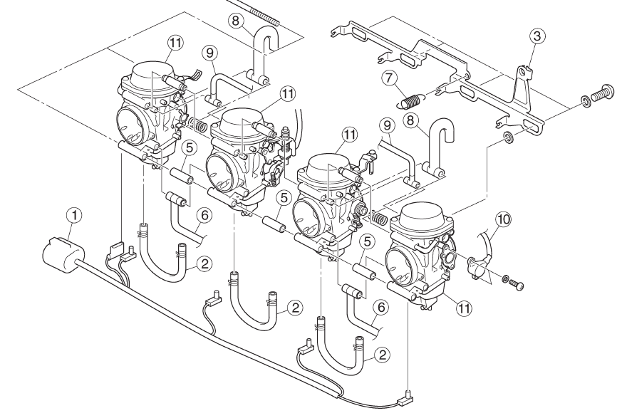

Does anyone know if the fuel inlet T's attached to the carb are replaceable?
Broke one of mine while pulling the carbs to clean, went to pull one from the parts machine and one was already cracked and the other broke very easily while removing the hose.
Local Yamaha dealer can't find the part in their system.
It's on the hose labelled #6 on the diagram in the service manual.

The fuel inlet tee fittings are not available seperately.
Man and Snow
I was able to get two tees or pipes as they call them. $12 can. at the dealer. Part # 5DM-14396-10-00. Not too hard to replace. Just a bit of a pain.
Update: This part # I suggested is for the air venting tubes and not the gas line tees. I am now stuck also trying to find some gas line tees for my 2004 RX1.

Where did you find this diagram and how can I get the part # for the #6 Tees for the fuel lines ?Does anyone know if the fuel inlet T's attached to the carb are replaceable?

Thank you for the help. However, 57 are for the air venting tubes. I actually am told it is 51 in this diagram . Although the picture does not show it as a tee. They are no longer available. i have also searched the Mikuni website and cannot find anything . This is the part needed.

I'm not so sure #51 is the T you are looking for as that appears to be the pipe circled in red. I have a rack of carbs I separated for the T's circled in blue. What I found to be the case with T you are looking for is that the rubber sleeves (circled in black) can be bad:

The brown tees with the bad boot as you say, is what I am looking for. How much are you asking for 1 or 2 of them ? feel free to send a PM.I'm not so sure #51 is the T you are looking for as that appears to be the pipe circled in red. I have a rack of carbs I separated for the T's circled in blue. What I found to be the case with T you are looking for is that the rubber sleeves (circled in black) can be bad:

I really wasn't thinking about selling them; at least not yet. I just wanted to point out what I found with the rubber boots on them. I still have to separate my good rack of carbs and not sure what I will find with the remaining T's other than the ones I know need replaced.

The good news is the fuel inlet T part number for a RX-1 is 8FA-14251-00-00 - they were never shown on a microfiche - now the bad news... they are no longer available in the US and we no longer have any - you may want to try some of the bigger Yamaha snowmobile dealers from that era and see if any have some still kicking around.
