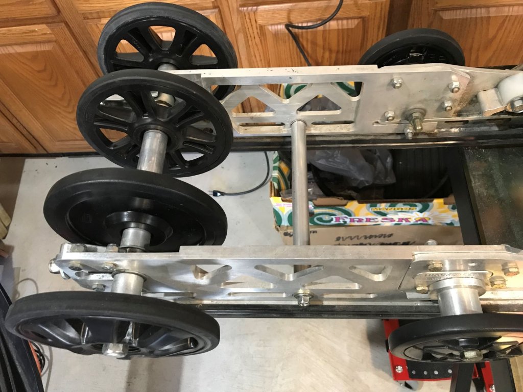

Hello. I’m redoing all the bearings on my 2009 Nytro XTX. Iv replaced all wheel bearings except the 2 rear axle outer wheel bearings as these are not service able. Looking for a oem style replacement wheels because I’m looking to keep the rear axle center wheel as that one has a bearing. so something that same size.

Is it alright to run 178mm on the outside and oem on the inside middle wheel?I believe factor is 130mm?These are from Yamaha with replaceable bearings:

All the rears including the middle are 178mm.Is it alright to run 178mm on the outside and oem on the inside middle wheel?I believe factor is 130mm?

The 130mm are the smaller idler "bogey" wheels. All the rears are 178mm.
- 7,698
any wheel that fits the same position on an apex xtx in a parts breakdown will work on your sled.

Got it all together and fixed now. Picked up two rear wheels with part number 8DF-47550-01-SL. They're 178mm and 20mm id and fits the Venture MP / Venture lite and they have replaceable bearings.
The bearing was cracked and separated on one of the old wheels, luckily nothing was badly damaged. Just a small groove in one of the the axle cover tubes.
