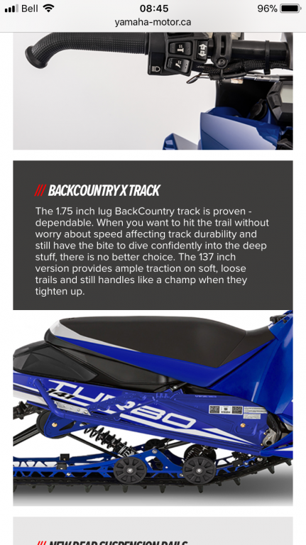

The XTX-LE says it comes in a 141 AND 137 length but the dealer says there is no listing for a 137 version. Anyone know about this? The Yamaha website mentions it.

The XTX-LE says it comes in a 141 AND 137 length but the dealer says there is no listing for a 137 version. Anyone know about this? The Yamaha website mentions it. View attachment 139004
Nothing on our price list for a 137
PowderFalcon
Pinnin' it!
Bummer. Thanks for that info!
