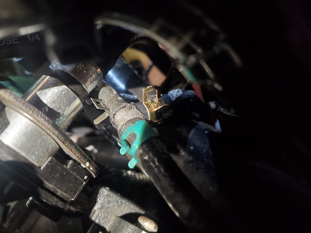

I found a leak at the little plastic T next to the fuel rail that goes to the regulator. The hose TD supplies with the regulator has an ID that is to big for the T. Replaced with a smaller ID hose and now it's all good.

I found a big leak by fuel reg too. All factory stuff in that area on my sled and I've owned it since new. There's nothing even close to do any damage to this hose!I found a leak at the little plastic T next to the fuel rail that goes to the regulator. The hose TD supplies with the regulator has an ID that is to big for the T. Replaced with a smaller ID hose and now it's all good.
