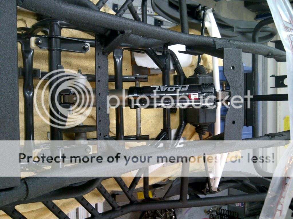

Got proper bushings and bearings from Nextech for the float.......fits like it was made for this sled
What size Float shock (Part#)? What bushings/bearings are needed to make it fit?
TURBLUE
- Nov 1, 2005
- 623
- Southern Alberta
- Sidewinder MTX
The number on the shock eyelet it
6268-132906
950-50-049
Basically made the bushings and bearings for m10 bolt....and as narrow bushings you can get....curt at Nextech will know
6268-132906
950-50-049
