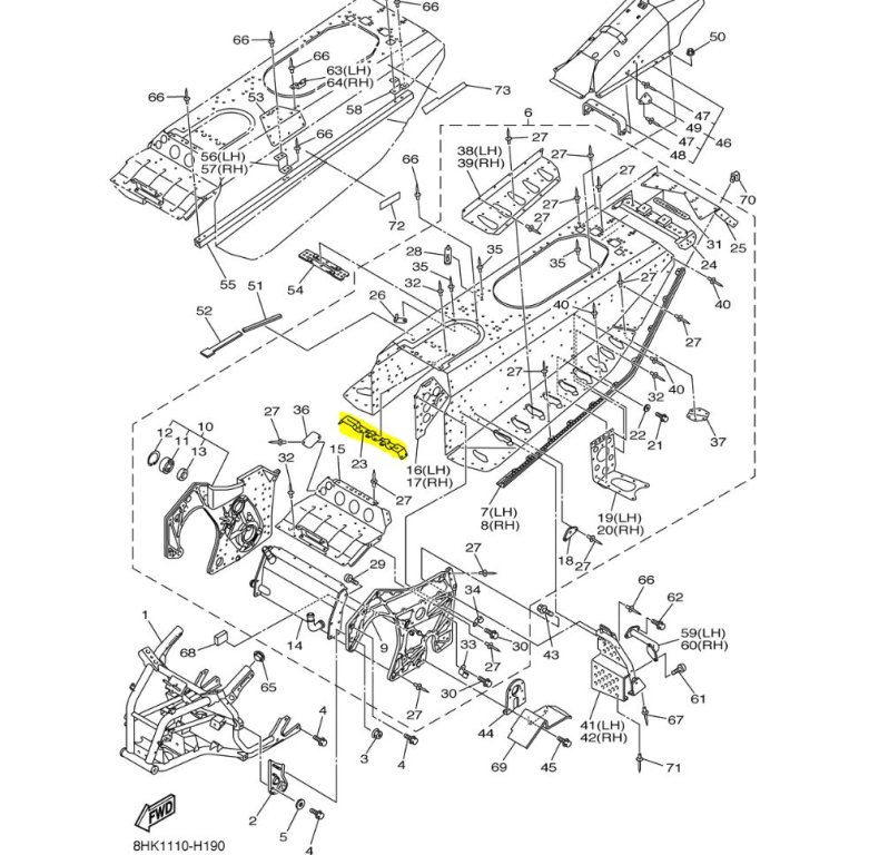

My Nytro was very loud last weekend. While inspecting I found my header pipe had separated from the muffler a bit. While taking a look I also noticed what appears to be a broken bracket in my tunnel.
The sled is an ‘09 RTX SE which was stretched to 144. I bought the sled with the MBRP header/muffler installed. The previous owner did some work in there with said header/muffler. He also installed a mountain cooler.
Any idea what this may have been? Something I need to replace?

those are the tunnel protectors that keep the track off the exh. from the looks of how the exh broke, i would check for loose rivits under the fuel tank that hold the tunnel to the bulkhead. on the delta box sleds, the exhaust would break like that when those rivits came loose.

Don't have Nytro to confirm but judging by the parts schematics and the description of part #23 (PROTECTOR, MUFFLER), I will venture to say it is that:

I'd say #56,57Don't have Nytro to confirm but judging by the parts schematics and the description of part #23 (PROTECTOR, MUFFLER), I will venture to say it is that:

I think you're right. 56, 57 is what's left. They probably hold 23 in place.I'd say #56,57

It looks like the exhaust protector is integrated with the tunnel protectors and brackets. Can anyone confirm? I’m putting my parts list together

No, I don't think so.It looks like the exhaust protector is integrated with the tunnel protectors and brackets. Can anyone confirm? I’m putting my parts list together

Those broken brackets were indeed tunnel protector mounts. When I bought my sled it had been stretched to 144 for off trail UP riding. The protectors had already been removed to accommodate a 2in Challenger track. I guess hacking them off was good enough for the other guy.
I drilled out the rivets and removed them for my peace of mind.
