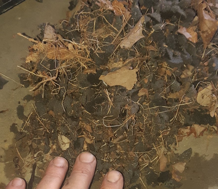

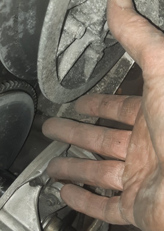

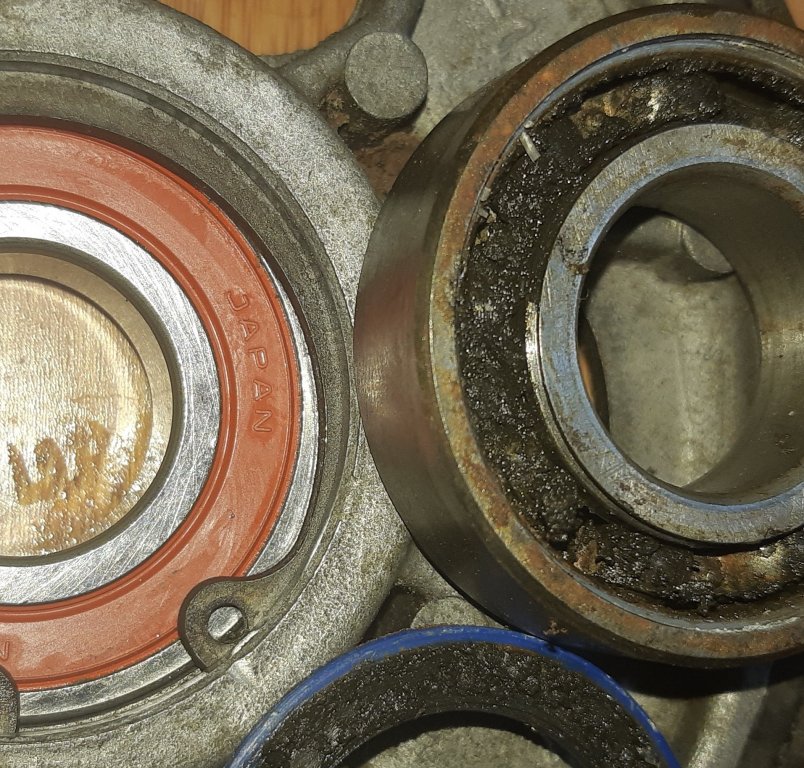

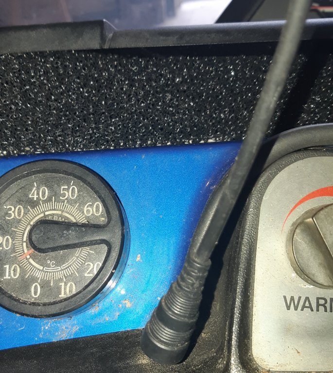

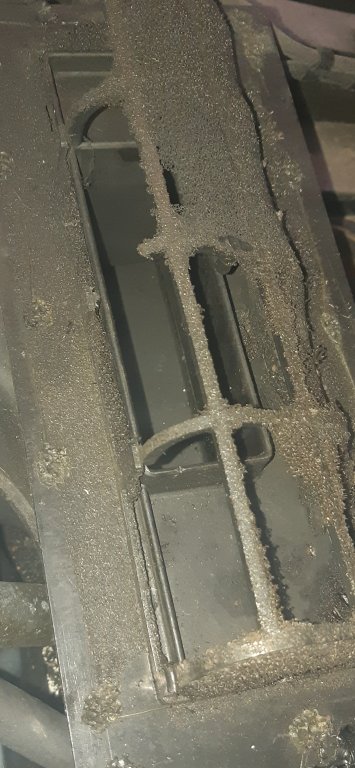

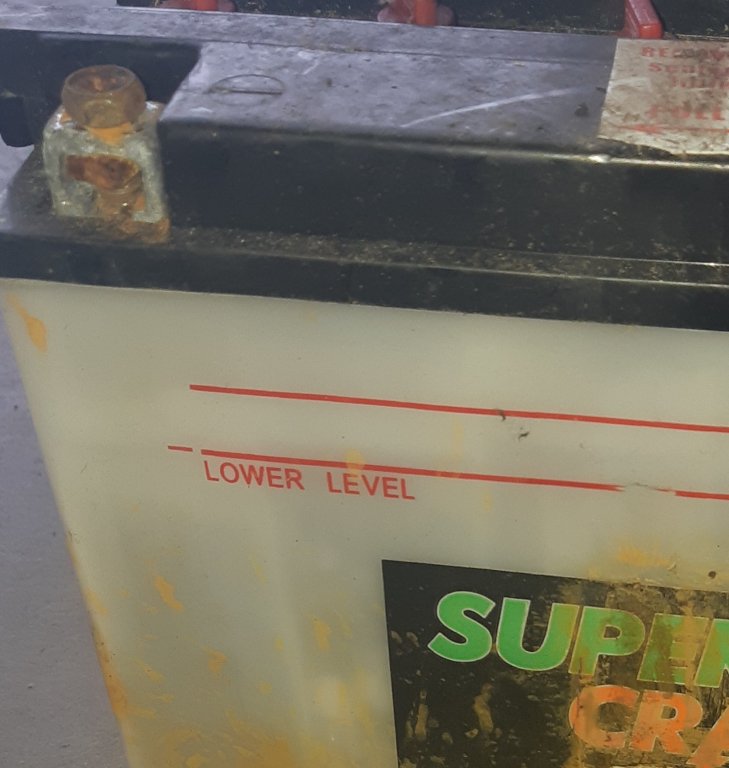

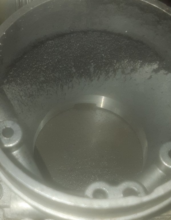

Finished my bud's Venture...☆Note to self☆...never offer to fix up/get running a buddies 24 yr old sled that's been sitting in a field the last few yrs....for free....lol
Installed new slides a few days ago...takes me an hr on my Nytro...took 3 on his Venture...altho I installed his with the skid still on. Both slides splintered, popped off rails, bound up...blah blah. And yeah, even w copius WD-40 lubed on rails and slides....and all over my arms, face and shop floor lol. But got em on eventually.
Replaced 4 wheels and bearings, new plygs, total carb clean, fixed broken mirror, replaced hood foam, air box intake, disassembled 4 yr old mouse nest (did not reinstall), changed out carbides...ROYAL PITA, cleaned clutches, installed new slide stopper, new throttle side heated grip, new battery, adjusted track alignment and tension, lubed skid, fixed headlight, cleaned belt guard, lubed front end, adjusted choke and throttle play...and done. 1/2 choke, one pull...fires up and purrs like a kitty.
