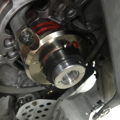

Check your secondary spring for signs of binding?

As a total idiot when it comes to clutching, I am note sure what I would be looking for! Could I have done something when installing the OSP adjuster? I followed the video instructions exactly, and did not take anything apart, other than removing the 3 bolts and washers from the back. Could I have done something that would cause the binding, or would it be "unrelated" to the OSP adjuster installation?Check your secondary spring for signs of binding?

Tightening the adjuster will open the clutch and create your lag. Loosening it will close the clutch and increase your creep. Aka less threads showing on the outside of the adjuster = a more closed clutch and more creep( and higher belt height). More threads showing = a more open clutch and less creep (lower belt height).

To looks for spring bind in your secondary is when your spring is compressed the coils don't have enough room to twist and they are binding you can look for paint missing on the sides where they might be touching. Just an idea. Maybe try a new beltAs a total idiot when it comes to clutching, I am note sure what I would be looking for! Could I have done something when installing the OSP adjuster? I followed the video instructions exactly, and did not take anything apart, other than removing the 3 bolts and washers from the back. Could I have done something that would cause the binding, or would it be "unrelated" to the OSP adjuster installation?
How many foot pounds do i tighten the secondary bolt to ?

The single secondary bolt is 46 ft pounds the helix tower bolts 17 ft poundsHow many foot pounds do i tighten the secondary bolt to ?

I believe that is the earlier version. The latest has a bit longer threaded part. Mine looks the same as yours and never had a problem.

Ya, thought that it would be new stock! Look back on this thread and i think you will see what im talking about. Been riding mine all yr and never had a problem.

Im buy on but after two ajustement I wa stripped. WOW 200$ scrap

Well I would contact them and I am sure they will help you resolve the issue. I, and hundreds of others here use this with out any issues and really like the product.

I like this product but i'm buy to #*$&@ performance and dont have Any Warranty. It expensive for second test. Excuse m'y english, i'm french.Well I would contact them and I am sure they will help you resolve the issue. I, and hundreds of others here use this with out any issues and really like the product.
